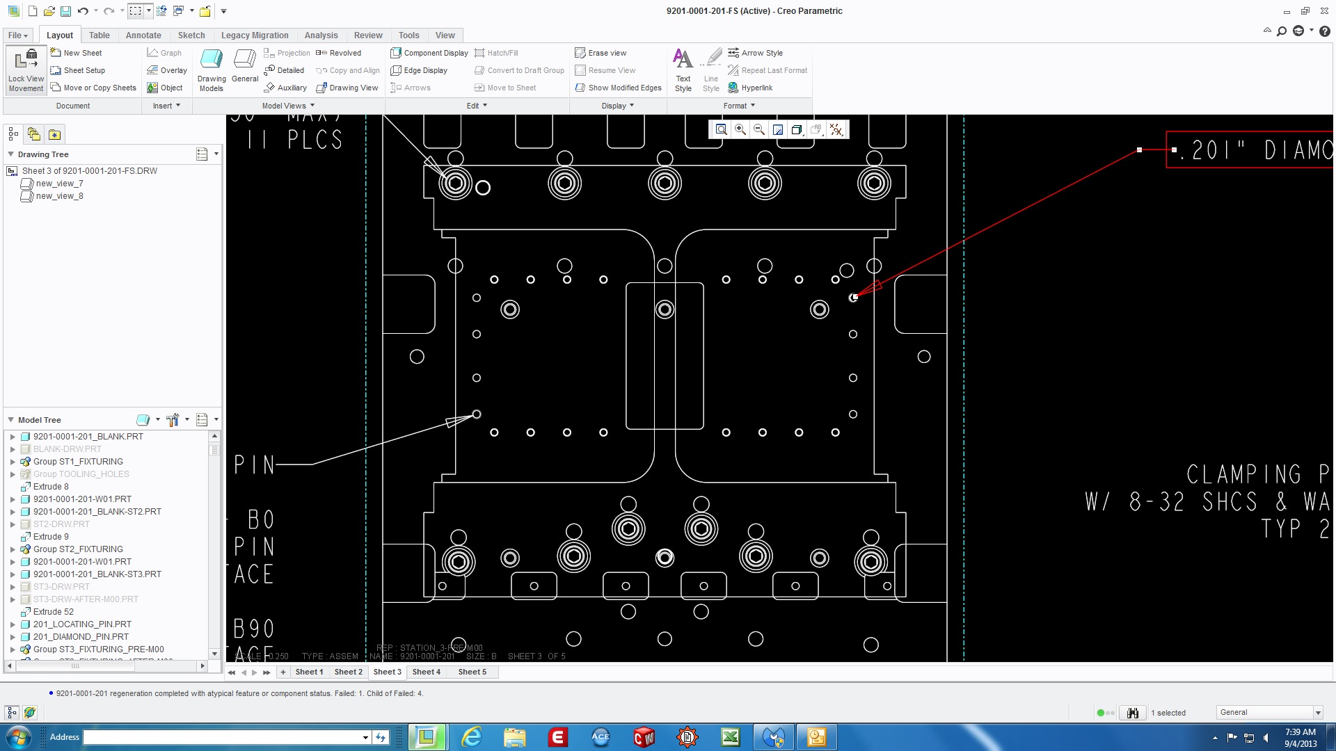

In my assembly I have a transparent component. (Its acctually a Workpiece in manufacturing.) The problem is that when I create a drawing with this assembly I can see thru this part. I can't see the hidden lines in this part, but I can see all of the lines in the fixture behind it. I would like to have this component display on the drawing as if it was solid. Is there a way to change this in the drawing?

Can you post a screenshot?
Sep 4, 2013 11:43 AM UTC
The part you see is my workpiece, which is transparent in my assembly. You can see the tooling holes and pockets in my fixture thru the part.

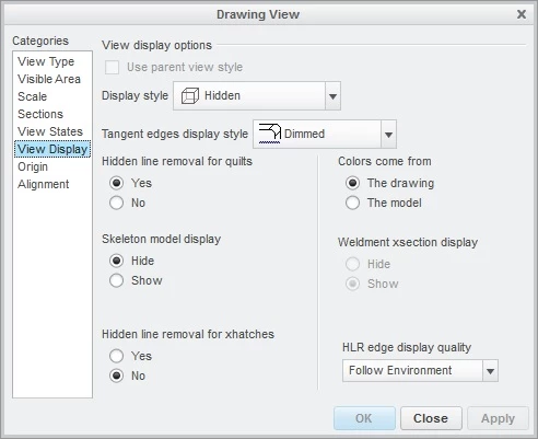

Even with Drawing View > View Display > Display Style set as "Hidden" or "No Hidden"?
Sep 5, 2013 2:16 PM UTC
Matt - I do have the view display set to No Hidden and I know this is active because I can't see thru the plate on my tombstone.
Antonius - I don't have any cosmetic threads in the assembly. The rectangle in the center of the part is a cut-extrude and so is the series of 6 rectangles on the bottom edge of the part, so all features can be seen thru the part.
