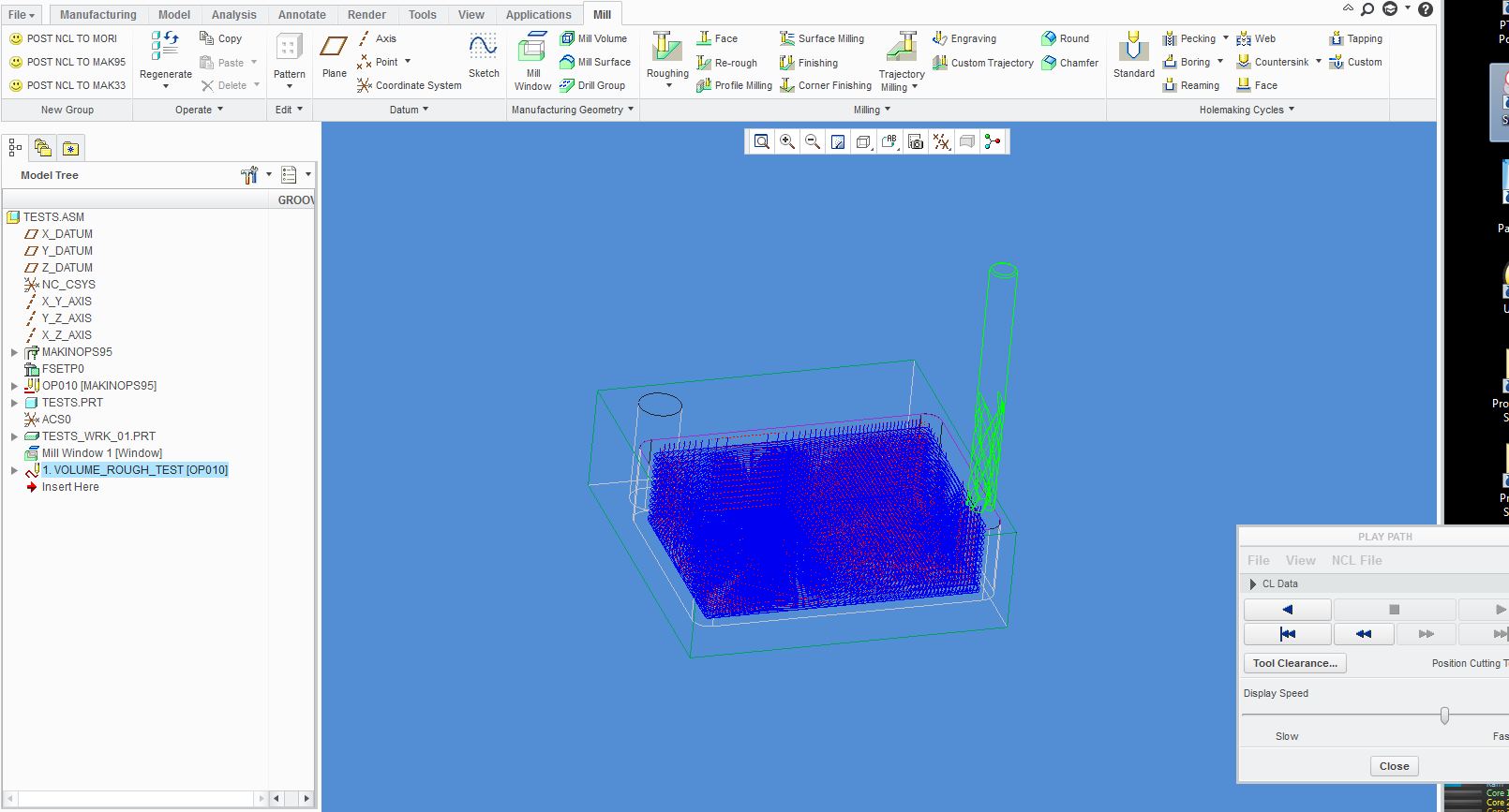

Gentlemen,
I am relatively new to programming using Pro NC and I am wondering if anyone knows much about the "CONSTANT LOAD" function for rough voluming. Everytime I try to use it in a closed pocket it retracts when it encounters a wall. It creates a 3D curve retract back to the retract plane for the sequence. I have had success going through channels but I had to use a retract plane that was just above my cut plane. It doesn't seem very safe to create a retract plane that is down inside a pocket.
I would appreciate any insight or links to tutorials about this tool path. It looks like Mastercam has Pro beat in this area.
-Scott

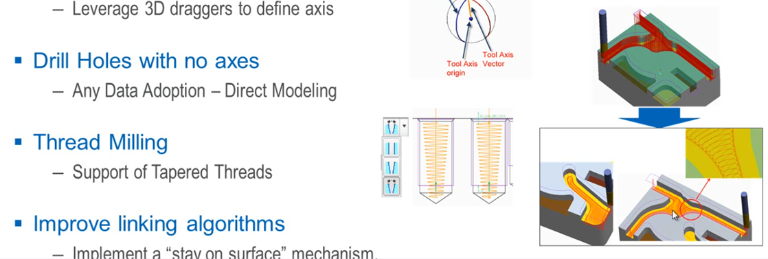

Scott,
Jose Coronado posted in July, coming improvements to “Linking” otherwise known as retracts.
It hard too see, but the image below the difference in amount of retracts.
Hang in there.
Barry

Scott,
Try these Parameters. With these it will only retract the retract amount plus the pull out disatnce for each step in volume roughing. Not all the way to the top of the part. I am not sure if it will go around or over a boss in the pocket or what will happen if there is an l shaped poocket, but at least it stays down closer to the cut. I need to do more testing but it's a start for you to try.
The last picture is a front view and you can see the red cuts are the rapids at each level of cut.As I stated above the retract is the retract amount plus the pullout distance in the parameters.
Dec 27, 2012 9:51 PM UTC
Thank you very much Steve! This is definitely closer than I was. I can't seem to get the tool not to retract back to the previous cut height though. I was hoping to only have the tool come up off the floor about 0.005" or 0.010". Any ideas on that?
Dec 28, 2012 12:03 PM UTC
Scott,
This as close as it gets, I think unless someone else has any Ideas. There was a discussion on here a while back about using mill volumes from Nick M. but I think you mentioned you were already doing the mill volume trick with the retract set to the floor of the slot or pocket to keep the tool down.
This has been a problem forever with ProManufacturing.
Steve
BarryS1-VisitorAnswer
Dec 28, 2012 2:55 PM UTC
Scott,
Hang in there.
Barry
Dec 28, 2012 3:31 PM UTC
Barry,
I forgot about that. It's supposed to be in creo3.0 next year isn't it ? Or when ever 3.0 is due out.
Steve
Dec 28, 2012 3:47 PM UTC
