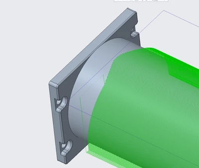

I am trying to use a conventional toolpath the finish the diameters of a tube with flanges welded on the ends. After generating the toolpath not all of the surface inside with milling window is being cut, attached it a picture of the toolpath.
Initially I thought the toolpath was being trimmed so the tool would not interfere with the check surfaces, but after shrinking the milling window down that did not seem to change. Does anyone have ideas as to why the end of the toolpath is being trimmed like this?
