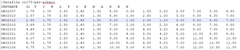

Hi everyone, I need to convert a library created in Emx 5.0 with .dat files to be read by Emx 13 is it possible?
I understand that now in the .dat files in addition to the variants, the information of the positioning axes and the surfaces for contouring are also included.

Thank you Sascha
actually on my PC I installed an old Wildfire with EMX 6.0, I had it read the file generated by emx 5.0 and it asked me to convert it to the version compatible with EMX 6.0, once this was done it saved the new .dat which apparently seems to be compatible with EMX 13...I'll check it out, the problem is that the library is big and I can't convert the files one by one.
