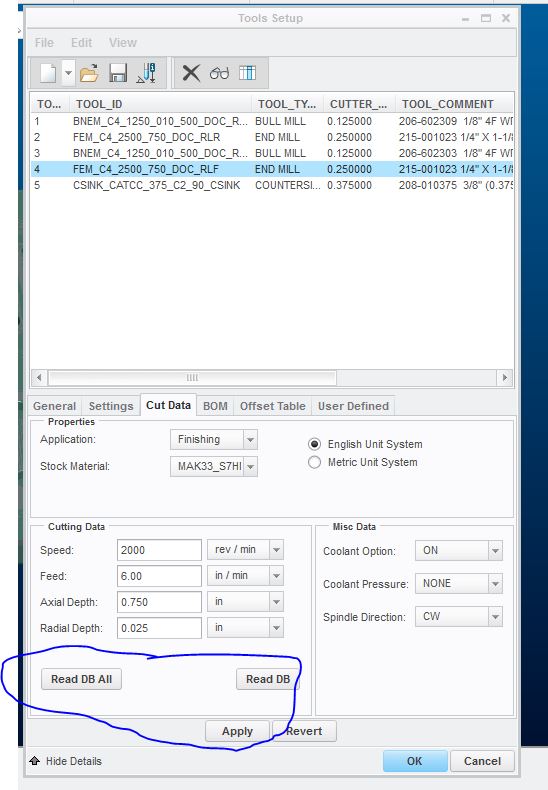

Jun 16, 2015 5:26 PM UTC
Gunter,
Long these same lines of apply and save changes the one that gets me frustrated all the time is in the tool setup.
If you have speeds and feeds setup in a database you have to hit the read database button and then apply.... If you don't hit apply you get nothing in the parameters!! you have to go back into the tool set up and reread the database and then hit apply then ok for it to read the data into the parameter page. I forget this about 5 times a day and is a great source of annoyance to me. You would think after using this software for a while you would remember that you have to apply changes but I am thinking a step or 2 ahead of myself quite often when I do this and have to back up and start over.
I would not mind seeing the apply disappear from this function. Isn't reading the database enough?
Steve
