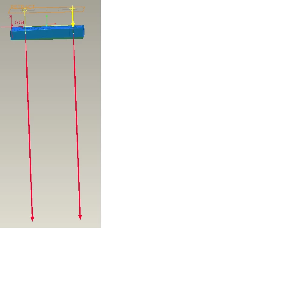

I am on Creo 2 M110 and notice that when defining drilling sequence
that these big red arrows show the direction of the path but they hide the
depth path. Is there an option to turn off the red arrows. They are more
annoying than helpful.
Thanks.

The red arrow is what I am trying to get rid of.
Jul 22, 2014 8:42 PM UTC
I would think that there would be a way to at least shorten them.
Jul 22, 2014 8:55 PM UTC
Try the config.pro option:
cl_arrow_scale 0
