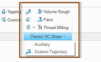

We recently updated from Creo 2.0 to 3.0 F000. Now I cannot locate the custom trajectory toolpath. I can fake it using a regular 3-axis trajectory, but custom trajectory did a better job of integrating the sketch into the step. It would be nice to have back. Does anyone know how I can find it?

Custom trajectory option is not available in Creo 3.0 (default options), as Trajectory sequence can be used for that. Still if you would like to get Custom Trajectory, set config option enable_classic_nc_steps yes and restart Creo. This will display a Classic NC Steps group.

Thank you. This does exactly what I wanted.
