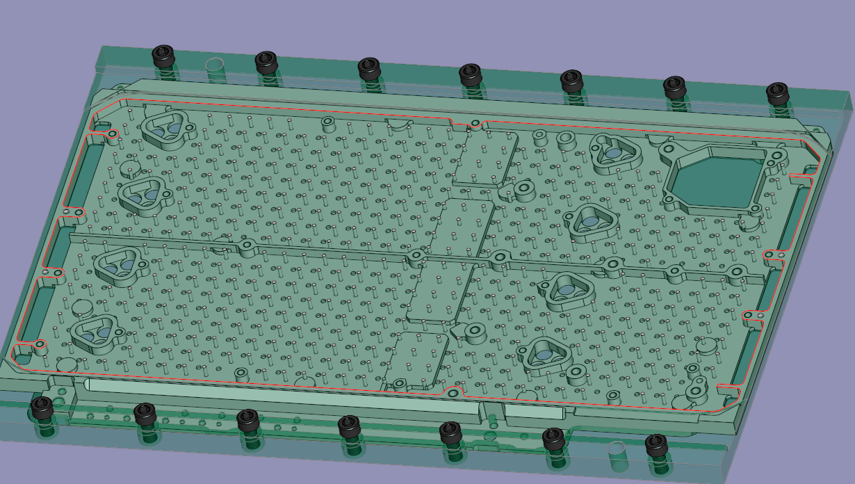

The problem with the Mill Volum may be the volume itself. I created a basic volume and with the same parameters it worked fine. I used a Gather for my volume and it looks correct but it must not like something. I know its not the tool or the parameters because it works with a Mill Window. The only problem with that is the Local Milling doesn't work like it should. It must be something on the part itself. The part was converted from a .stp file and a native file is out of the question. I'll have to keep digging.
This is the geometry I am trying to machine. Basically everything inside the red sketch down to the floor where the pins start. (With as little toolpaths as possible - HOT job)
Jan 9, 2015 7:55 PM UTC
I finally got it. I am using roughing and re roughing. It would have been sooner but it takes about 5 minutes everytime I change a parameter to regen the toolpath. I used min. step depth to trick it into not cutting certain slices (would be nice to have remove slice option like the old toolpaths).

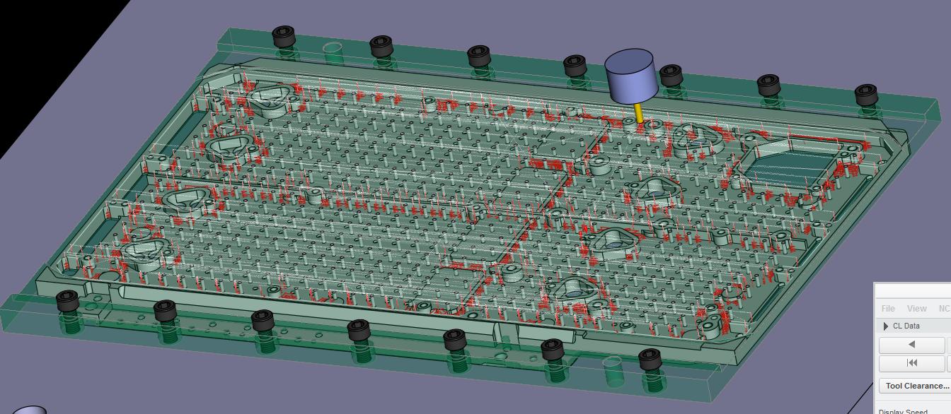

The only problem with re-roughing is you can't order regions like you used to be able to with local milling. And even the new order regions is wayyyyy slower (almost impossible for some of my parts) than it used to be when you could just select the regions in the order that you wanted. I know I've said this before but I wish there was an option to sort regions by shortest path like drilling. Of course there would be a parent to child relationship in some places where certain shelves are above others so they have to be cut first. But it would still save a ton of my time and a ton of cycle time.
this is what the re-roughing looks like.... lots of rapids

Nice looking part!! material must be aluminum. I agree with your frustration with the toolpath caculation time. I have done the rough rerough routines with small tight tolerance electrodes you can fit in your hand that will take 15 minutes to calculate the tool path for. I like the shortest path idea. manually sorting regions with order regions is a pain especially on big parts like yours..
