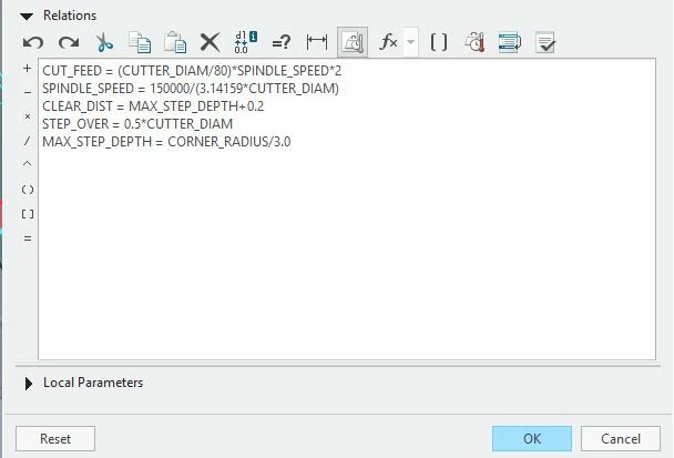

Creo 5.0.1.0 parameter relations
Has anyone figured out how to modify the default relations that auto populate sequence parameters yet?

Looks like site files are  the answer.

Nick,
How do you adjust for different materials ? or do you not change say for going from steel to aluminum.
I suppose you could have site files based on machine and material parameters.

We have dedicated task machines so I am interested in machine specific settitngs. I was more just annoyed with the auto population of settings 120k rpm was not going to work!
