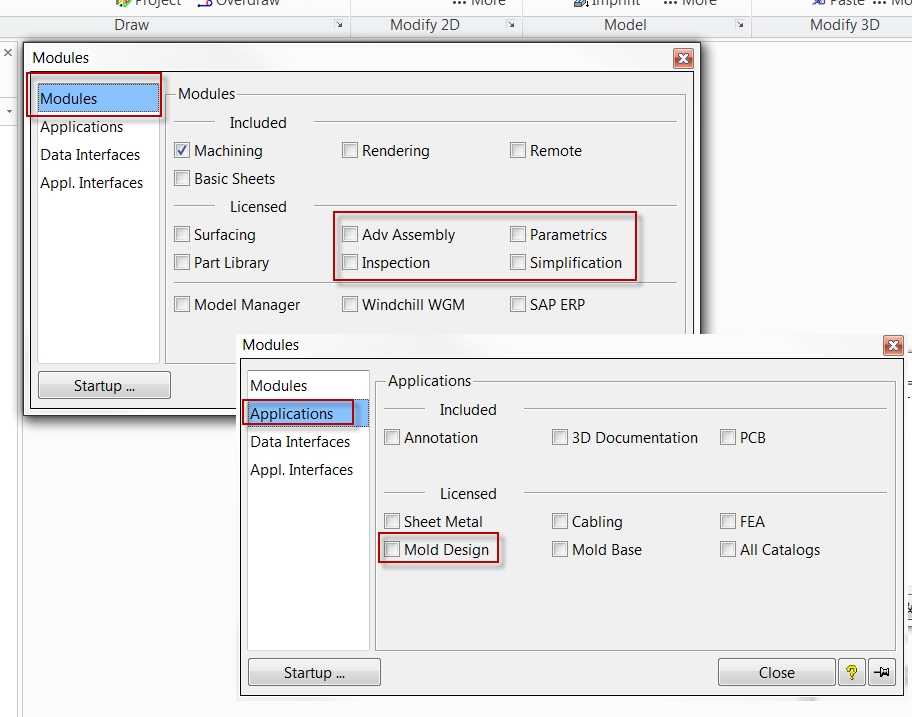

Feb 11, 2014 1:17 PM UTC
Simplification, Parametrics, Advanced Assembly, Inspection & Mold Design.

Feb 12, 2014 1:57 PM UTC
We have the Advanced Design license and I just click on all the modules to see which ones reported using the license.
