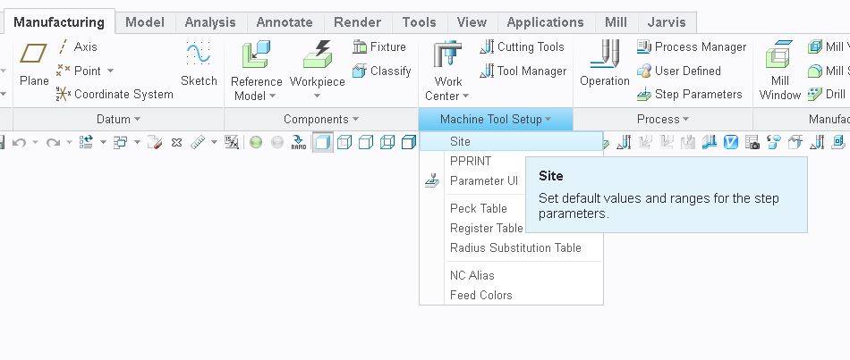

For example, I would like "COORDINATE_OUTPUT" to default to SEQUENCE_SYS instead of the current MACHINE_SYS every time I make a new tool path.
Also, is there a way to custom populate the quick parameter options under the "parameter" tab?  Common used parameters such as FIXT_OFFSET_REG used to set your G54-59, should be readily available, and I would not have to open the advanced parameter to access it.  Any way to do this?

You can modify site files for default parameters for all type of sequences & setup the default site files in your manufacturing file.

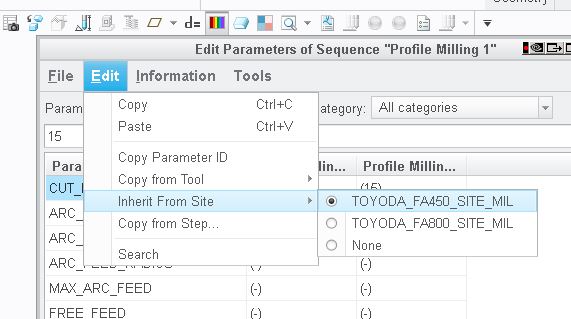

All the new sequences created after retrieving & setting the new site file will use the parameters from the given site file, for existing sequences you can go to edit parameters>edit>Inherit from site>
You will need separate site files for milling, turning & holemaking sequences.
