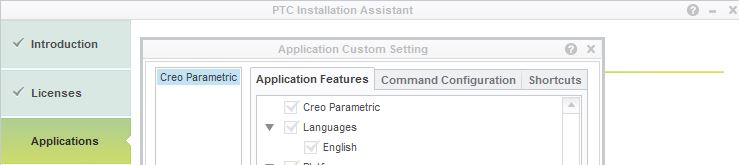

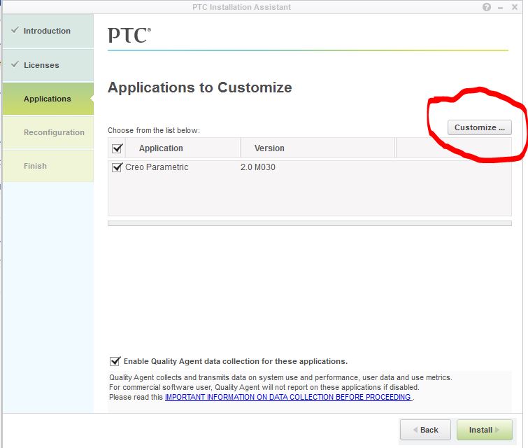

    It sounds like you haven't installed the vericut option.
    you need to run the set up disk again but select reconfigure.
    when you come to this screen
    select the customise option
    then you need to search throught the opptions on this screen and selecet the vericut option to install
    You need to complete the reconfig process, then you shoul have the Vericut.dll

    Mar 10, 2014 7:33 AM UTC
    thanks a lot Wheelsofsteel that works!!!!!
