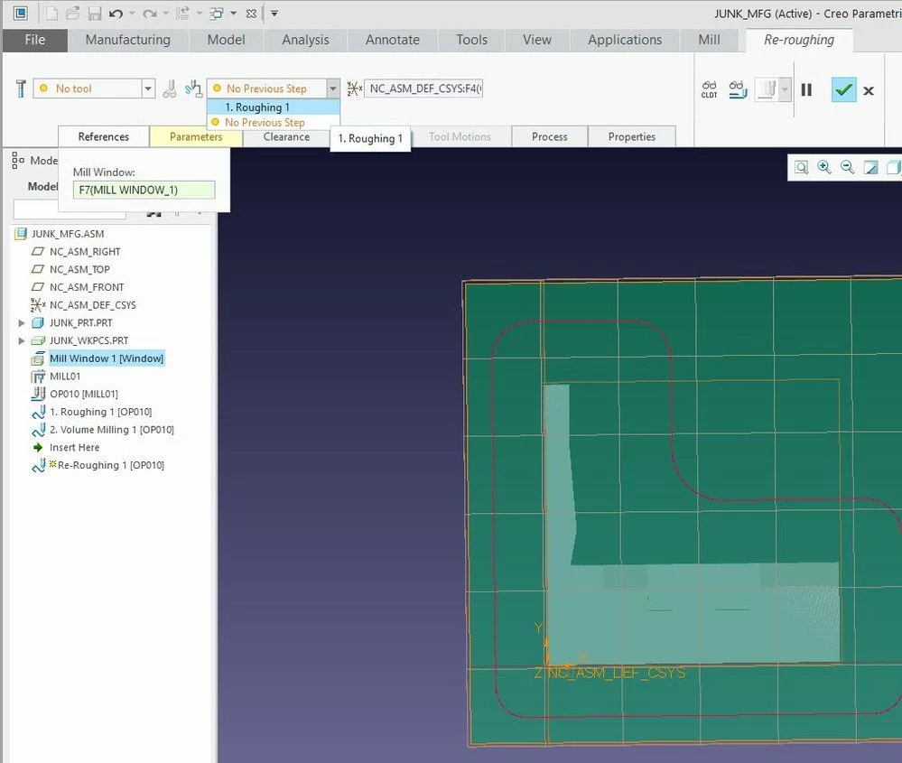

In Roughing:Volume Rough, you can select the option for the tool to run on, outside, or inside the window sketch. However, the Volume Rough option doesn't show up as a prior step for the Re-Rough sequence.  I set up another sequence, using Roughing:Roughing which then shows up as a prior step option in the Re-Rough, but the tool does not stay inside my sketched window.

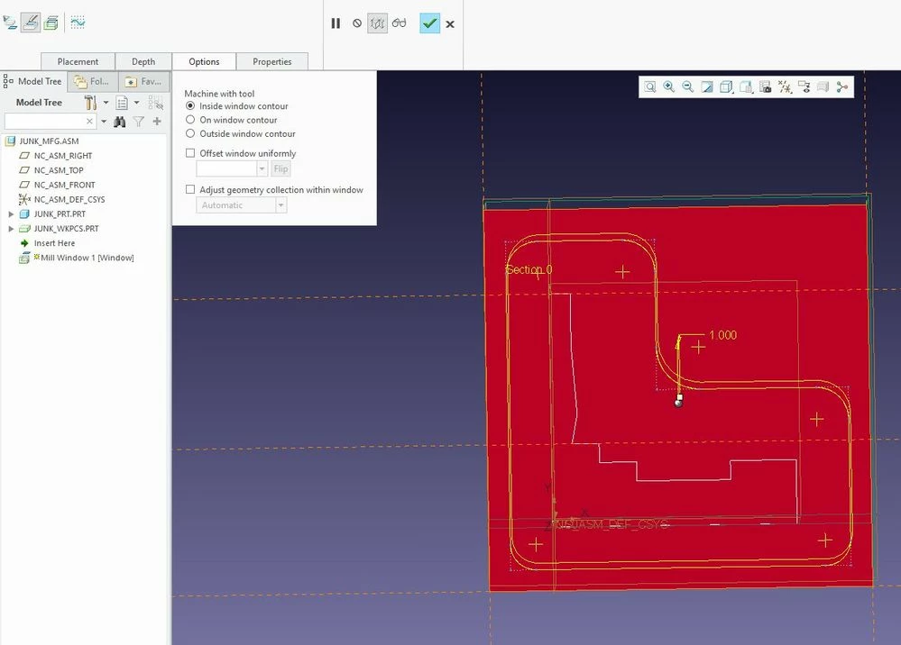

I didn't see the ALLOW_ENTRY_OUTSIDE parameter in the Roughing:Roughing sequence or in the Roughing:Volume Rough  option, what sequence selection is that parameter part of?  I do have the Inside Window Contour option set in the Window definition.

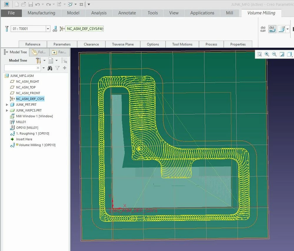

Here's the Roughing:Volume Rough option toolpath, which stays inside the window:

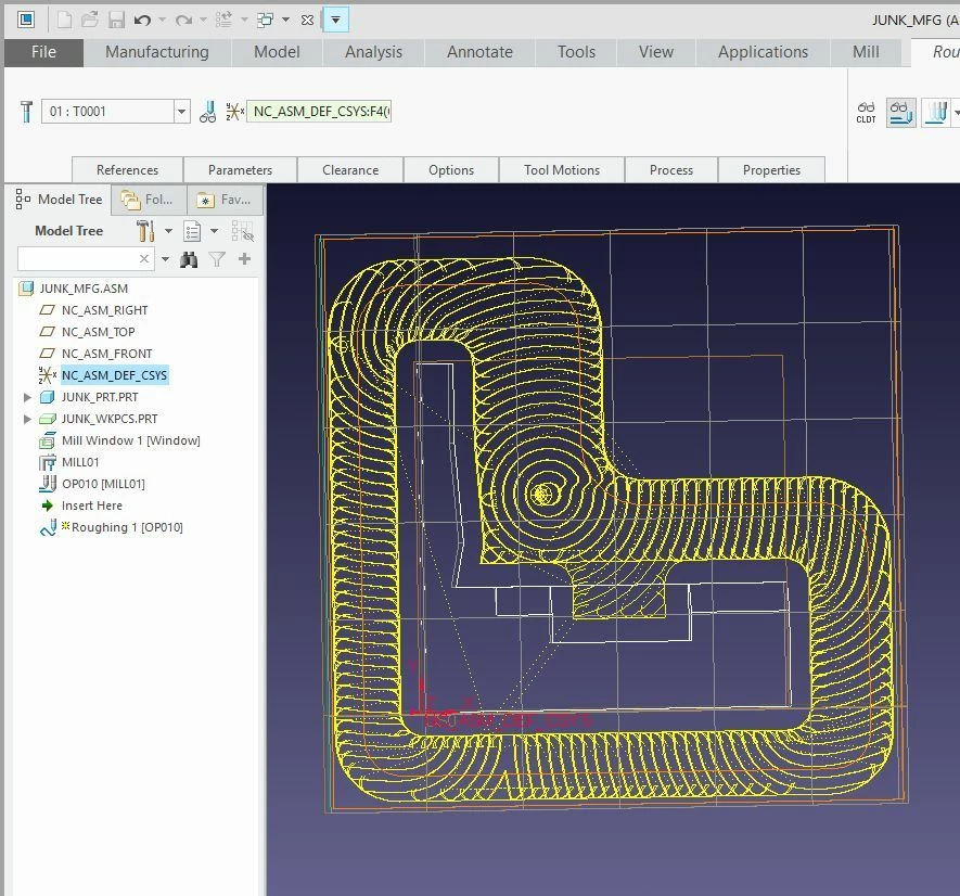

And the Roughing:Roughing option which breaks outside the window:
But then when I go to use Re-Rough sequence, the Roughing:Volume Rough option doesn't show up as a prior step:
