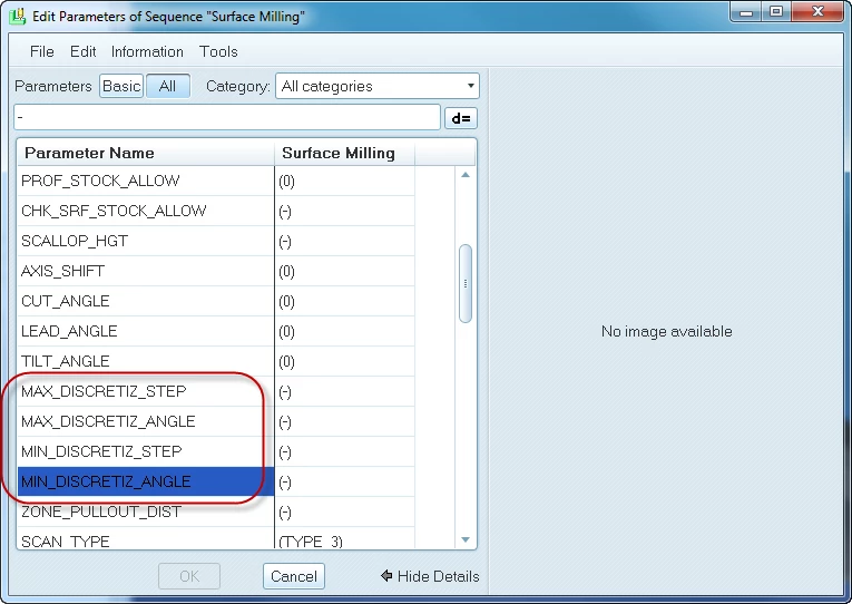

Is there a way to change the settings on a trajectory 5 axis curve following toolpath to have less goto points and maintain a tolerance?
Attached are two bitmaps to explain better.
Thank You
Jul 27, 2011 1:55 PM UTC
These 4 guys should do some help:
Rgds
Daniel
