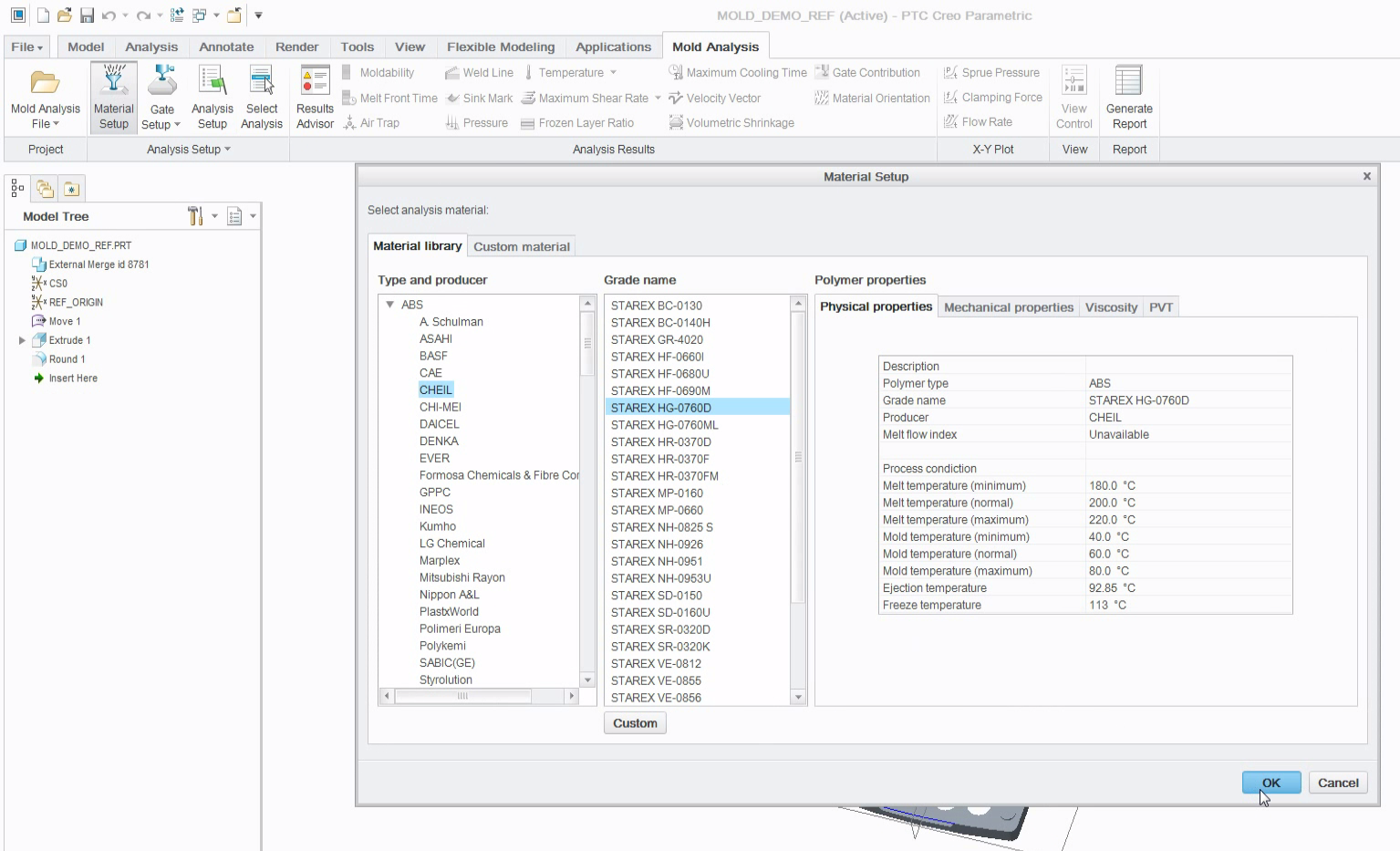

To run an analysis on your part, follow these steps: First, click Applications > Mold Analysis. The Mold Analysis tab opens. Click Mold Analysis > Material Setup. On the Material Setup dialog, select a material from the Material library. If the material is not available in the library, you can modify the properties of an existing material.
The Material Setup dialog is used to set the model’s material properties.

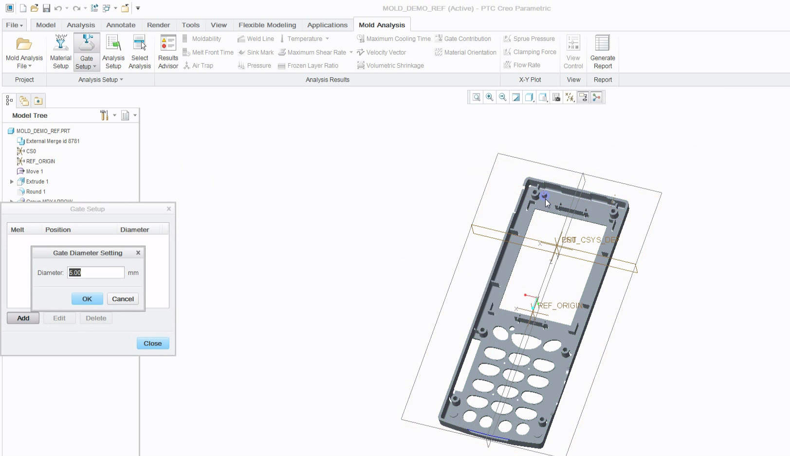

On the ribbon bar, click Gate Setup to add gates on the model. You can add a gate location manually or automatically. You can also edit the gate diameter.
Add gates manually or automatically, and then use the Gate Setup dialog to set the diameter.

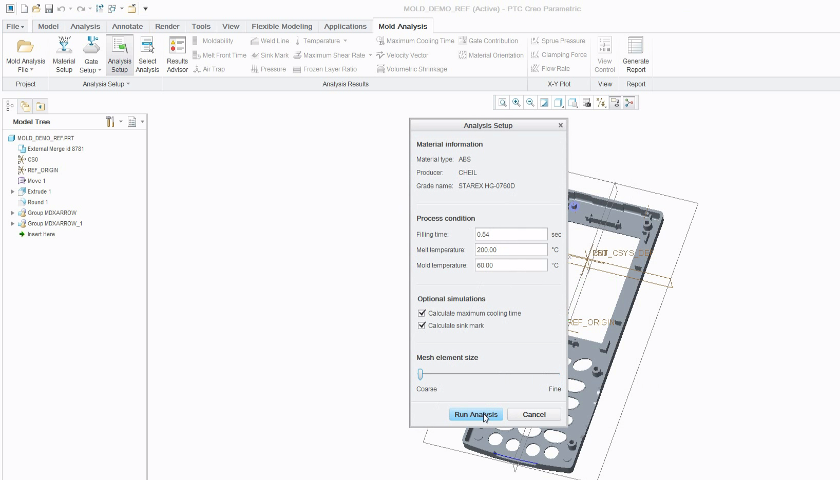

On the ribbon bar, click Analysis Setup to set up the process conditions for the analysis.Using the Analysis Setup dialog, select options for additional simulations for estimating the cooling time and sink mark. Select the mesh element size based on the accuracy required for the analysis.Once you have set conditions for the analysis, click Run Analysis.
You can perform multiple analyses by changing the material, gates, and process conditions on a model.

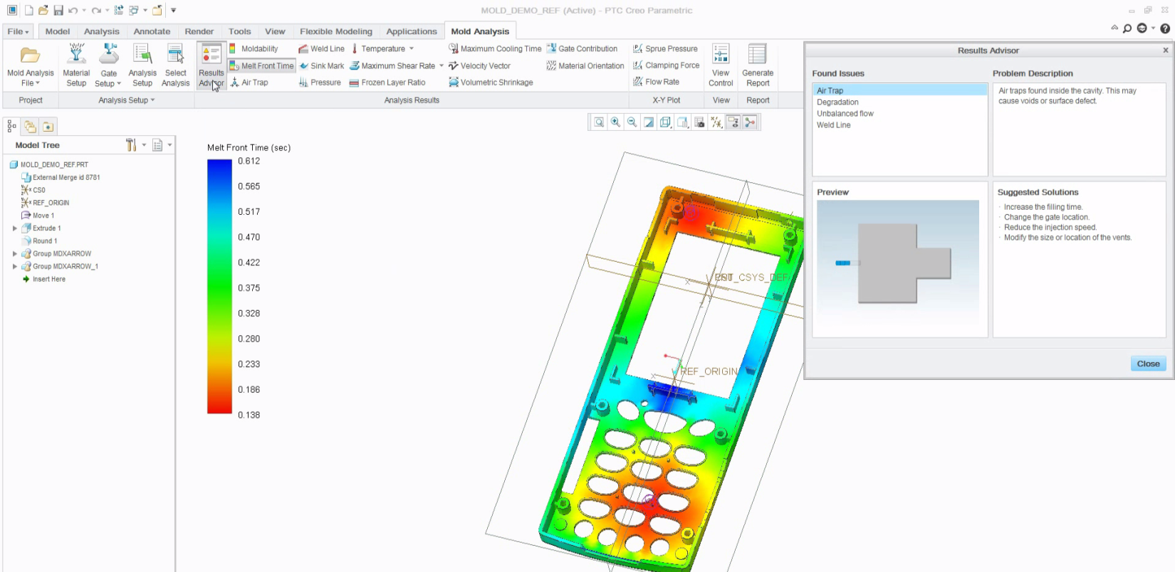

View the results, and then from the ribbon bar, click Select Analysis. Select an analysis from the Select Analysis dialog box and click the options in the Analysis Results and X- Y Plot groups. In addition, use the Result Advisor dialog box to view the issues found in the analysis. Click the issue to view the suggested solution.
Click an issue in the Result Advisor dialog box to view the suggested solution.
On the ribbon bar, click Melt Front Time > View Control. On the View Control dialog box, click Animation, and then click the play button. Ensure the mold fills in an even manner. On the ribbon bar, click Generate Report. Fill fields on the Create Report dialog box, and then click OK to generate the report. You can generate a detailed report of the analysis in the Microsoft PowerPoint (.ppt) format.
