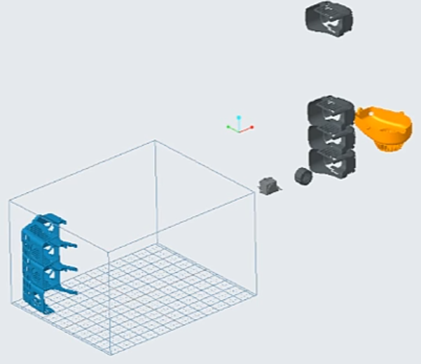

To explain the basics of tray assembly, let's start with one part.

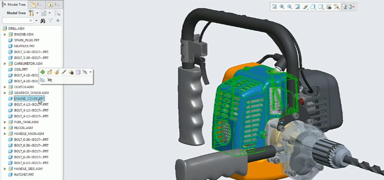

selectingcover.pngSelecting the engine cover to create a tray assembly.
You can prepare that part for 3D printing, then use automatic positioning and add other parts.

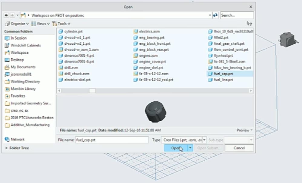

Place as many parts as you want into the tray.
Adding a fuel cap to the tray assembly.

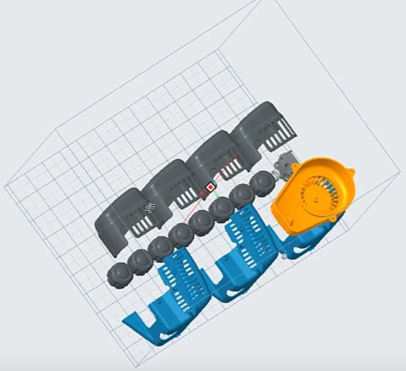

When you click Auto-position, the system arranges the parts inside the tray.
The parts are arranged automatically inside the tray.

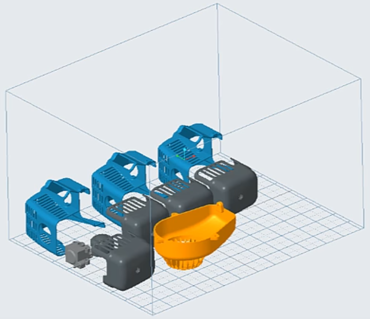

Let's create a pattern that has multiple instances of a fuel cap.
Adding eight instances of the fuel cap and then using auto-positioning to arrange them inside the tray.

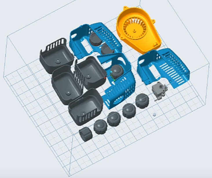

The next thing that you can do in the tray assembly is to create a nesting arrangement. Nesting places the parts so they use as much volume as possible in the tray assembly. Use nesting when the 3D printer can handle this type of arrangement.
The models have been rearranged using nesting.
