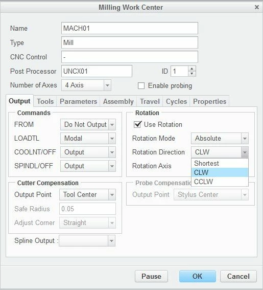

What would cause two different users, using the same mfg file, to get two different ncl outputs?
I get:
$$-> CUTTER / 6.000000
SET / OFSETL,  55
ROTATE / BAXIS,  ATANGL,  -90.000000
SET / OFSETL,  57
ROTATE / BAXIS,  ATANGL,  90.000000
SET / OFSETL,  54
ROTATE / BAXIS,  ATANGL,  270.000000
He gets:
SET / OFSETL,  55
SET / OFSETL,  57
SET / OFSETL,  54
ROTATE / BAXIS,  ATANGL,  450.000000
(Post takes care of overrotation)
Config setting, setting in machine, site, operation, nc sequence?

Oct 31, 2017 9:52 AM UTC
Hello Scott,
the problem is probably in the Work Center definition.
There is the parameter named Rotation Direction which can have three values: Shortest, CLW and CCLW (see attached figure below).
And each of you specified different value, probably.
This could be reason why CL-output is different.
I hope that will help you.
Rostislav

Nov 16, 2017 12:41 PM UTC
config.pro setting cl_rotate_sign_convention defaults to TABLE when it should be set to TOOL. All posts out good now.
