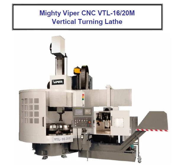

I currently use Creo for our machining software. We have three HMC's and the software works well. We are about to purchase a Vertical Turret Lathe with machining capabilities.
Will Creo support or work for this type of machine?

we have the workcell type Mill/Lathe for turning machines with additional milling capabilities.
Regarding the vertical orientation: This should be just a matter of defining appropriate coordinate systems and - if necessary - transform accordingly in the postprocessor.
