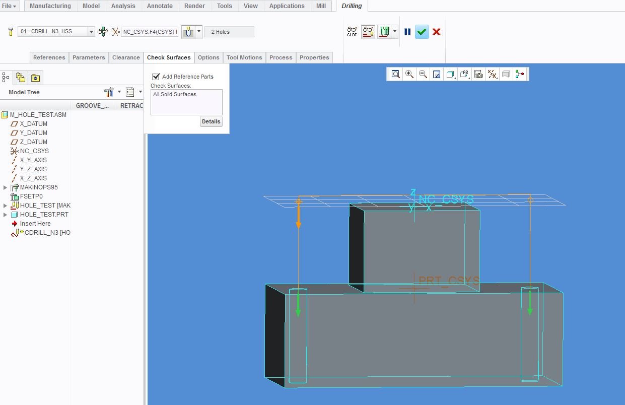

I encounter a situation from time to time in WF5, and now in Creo in which a drill appears to retract to the retract plane in the tool path view - but when viewed in material removal simulation the drill travels through the part from on hole to the next. I am curious what other people do to overcome this?
The operation is set to use the retract plane always. The retract plane is 3"
Retract Parmeter is set at 3.85"
The holes lie on a flange 180degrees apart from one another.
The tool needs to retract after the first hole in order to clear the middle portion of this hub which is .85" taller than the flange. (Hence the 3.85" retract parameter)
If you place the tool on the tool path, it shows that the tool (even though it appears retracted) is actually at z=-.85".

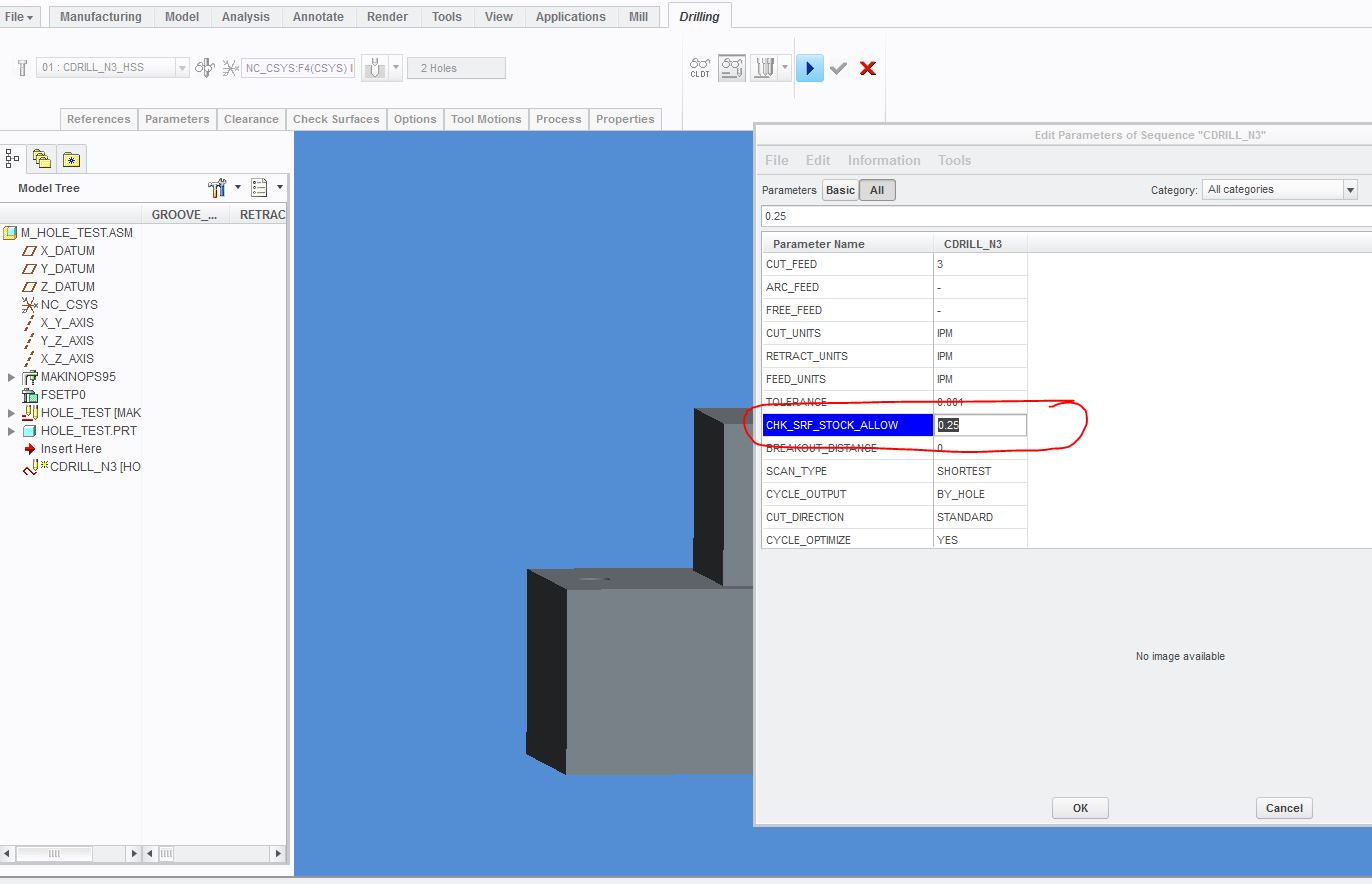

Matt,
I use chk_srf_stock_allow and set it to what ever clearance you would like.
Then select the part to check.
Keeps the tool off the part by that amount. Works for me at least.
Steve

Steve,
I tried it out with the changes. It didn't get me where I want to be. The only thing that seemed to work for me is to specify the highest Z plane as the drill hole's starting surface. I can do that, but then always end up having to add the distance from this Z plane to the depth of the holes in order to specify a blind depth of the hole pattern. What I'd like to do is specify that a group of Counterbores should be 1/4" deep from the start surface, not the highest Z surface. I would use "to selected" if the counterbores were constructed as an extrude, but since they are hole features I can't do that. It sees each hole surface as a different surface that way.
