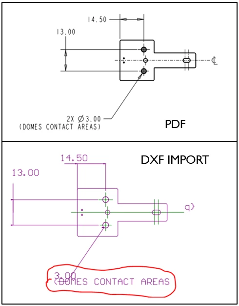

6-Contributor
Jan 24, 2022 8:01 PM UTC
I have tried changing the font to the default Times New Roman that Altium uses and it still came in as whatever this font is. It also doesn't explain the missing title block lines. I did try stroking texts with one of my exports and the text simply didn't show up.
