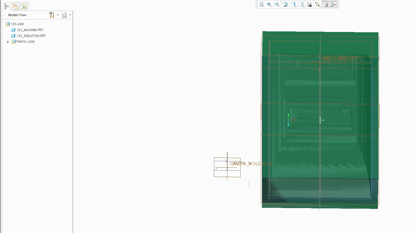

I've made a mold cavity and i want to place it in a moldbase but the size of the cavity is much bigger than the default EMX new project.
How can i modify the moldbase so the cavity can fit in?

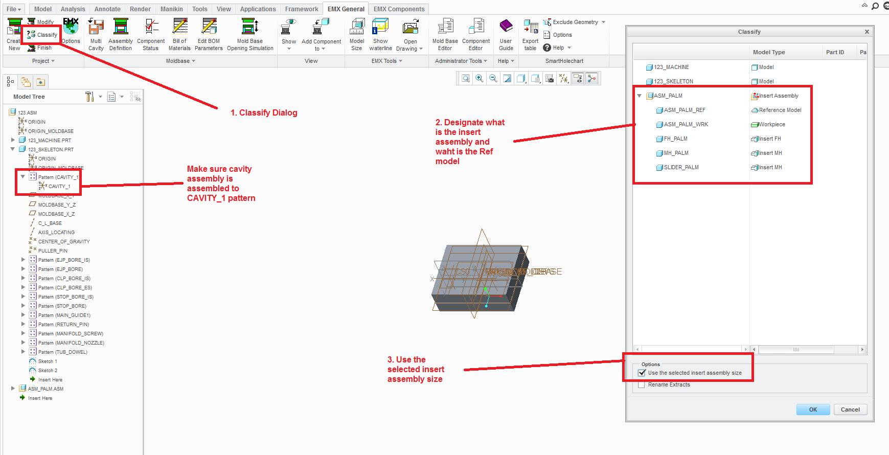

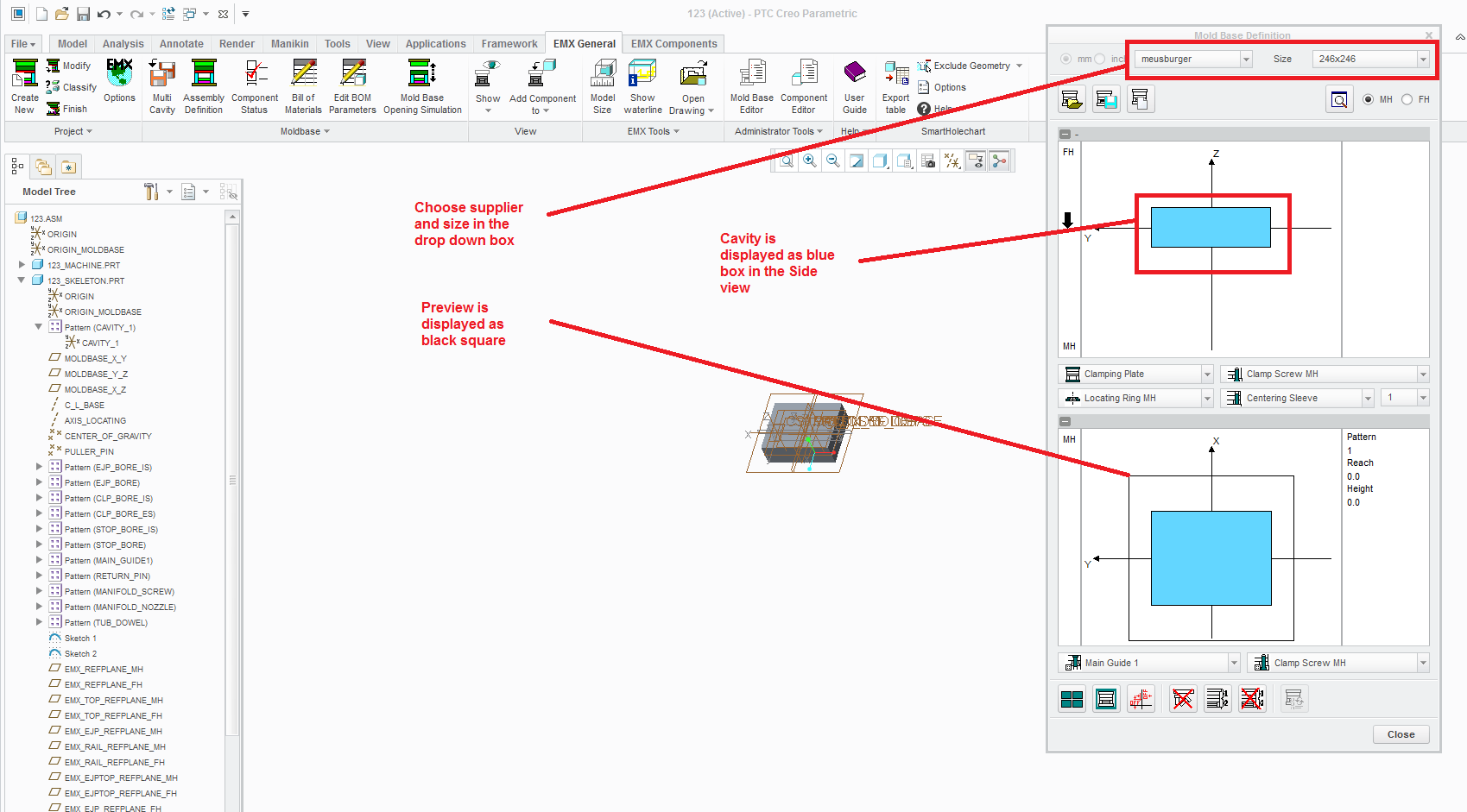

The Moldbase Size can be defined in the Moldbase Definition Dialog. See picture attached
1. Assemble cavity correctly
2. Chosse size in mold base definition
