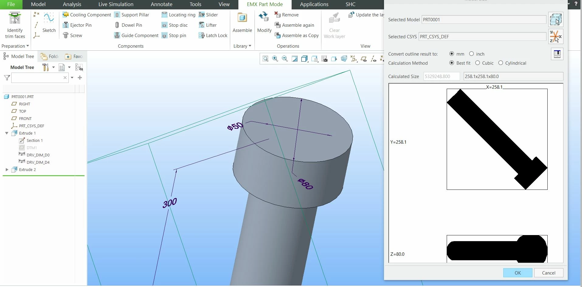

Hello Community,
I am adding an inclined part in EMX Assembly by top-down process.
Part getting added in assembly successfully, but while generating BOM the size calculated by system is rectangular even part is like pin (Circular).
(Actual Size : Dia50 x 300mm - Calculated size: 258 x 258 x80)

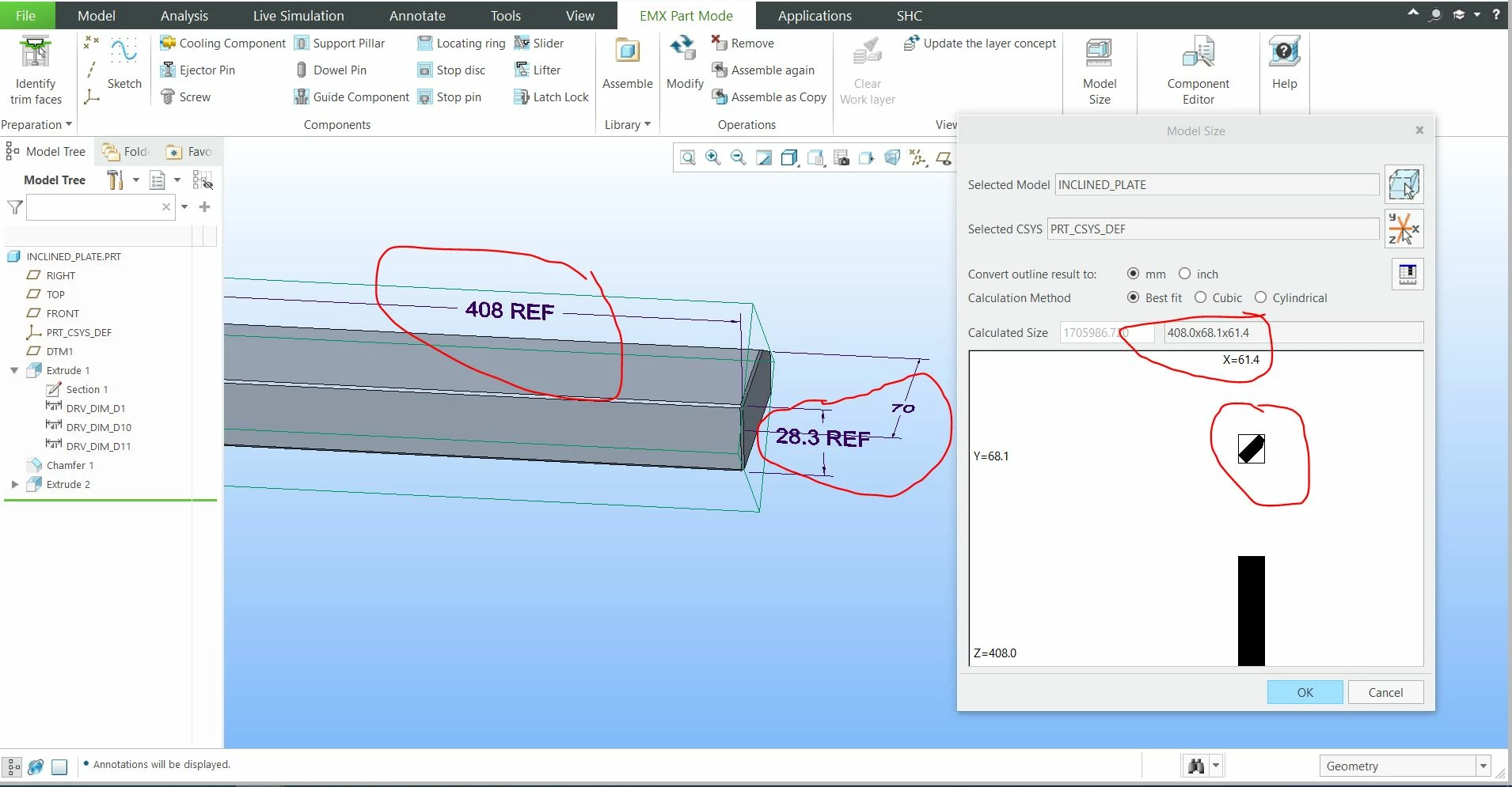

Similarly  I am assembled a rectangular plate in inclined way by topdown process, wrong size calculated.
(Actual Size : 408x 70x 28.3 mm - Calculated size: 408 x 68 x61)
Please find the attached screen shots.
I used standard Demo data set for trial of EMX assembly.
Looking for response.

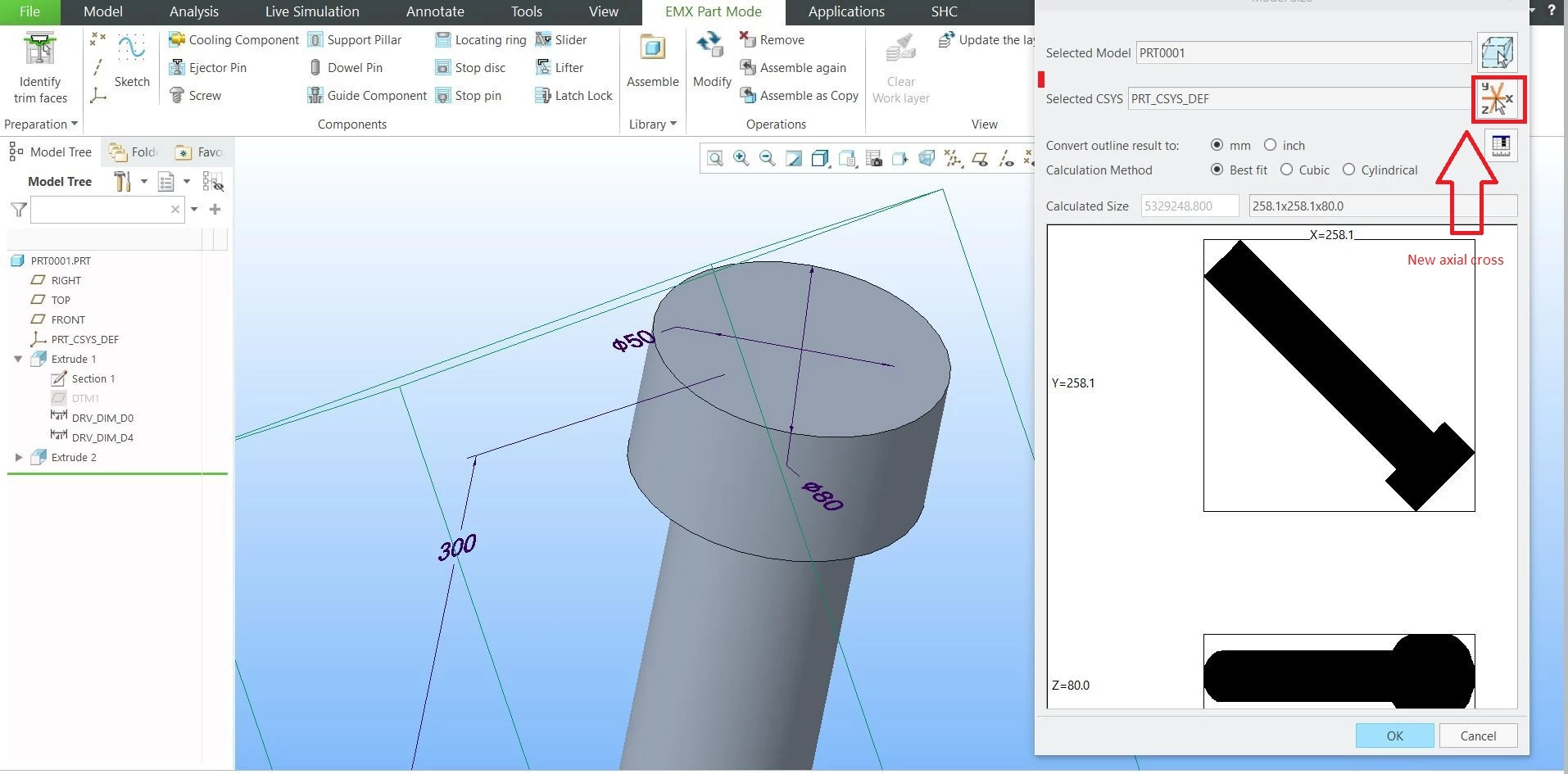

You must make a new axial cross in the model.And to mark it see picture.The parts that are formed in the assembly at an angle do it that way.

Apr 17, 2020 6:49 PM UTC
Thanks for the Solution..!!
Its Working..
