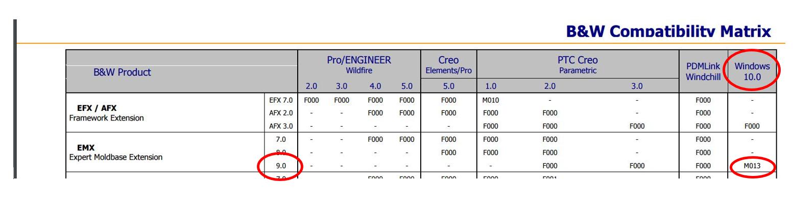

From B&W's compatibility chart, I see that Windows 10 requires EMX 9.0 M013? Find the chart here at http://www.buw-soft.com/data/pdf/compatibility_matrix.pdf

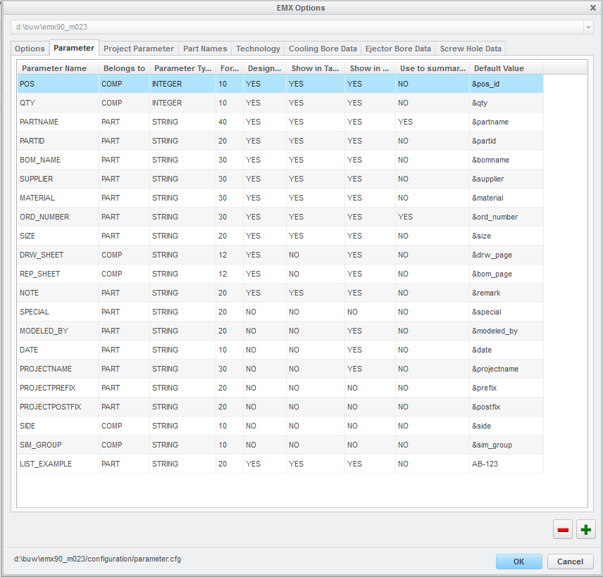

By default EMX comes with a default parameter configuration.
In case the Parameter setup is customized, the behavior of the BOM might be different.
Some answers to your questions.
  • that the BOM reorders itself even if you save out of the BOM and come back in immediately
The BOM does save the position id in the Parameter with the default value &pos_id.
This is a very important parameter. If this one does not exists the current BOM positions can not be saved.
  • Restoring a set of excluded parts (eg 4 support pillars) to be included in the BOM restores only one of the four parts
Excluded parts are not summarized in exculded parts area. You need to restore them individually.
Note: Summarizing of parts can be controlled with the column Use to summarize. You can set up rules here. In the default config parts are summarized in the BOM in cas the PARTNAME and the ORD_NUMBER parameters are equal.
It is also important that you have a parameter definded whichthe default value &qty is assigned to. EMX will the count the summarized parts and write the correct value into this parameter
  • Quantities are sometimes incorrect; sometimes even reflecting a zero.
This sounds like a issue with the Quantity parameter expalined above.
  • Some item numbers go missing when the BOM is printed by populating a repeat region table in a drawing ie the item (POS) is there in the BOM UI but not on the drawing. Regen and updating the drawing do not fix this. Saving the BOM to the clipboard and pasting into Excel puts them into the spreadsheet.
This sound like an issue with the Position parameter.
I hope this explains some issues. If you need further assistance, just write me a PM.

Just to comment on Windows 10 compatibility:
I have looked back in our project register and we upgraded all our workstations from Win 7 to Win 10 in June 2016.  On Win 7 Creo2 EMX8 M020 we had no issues with the BOM creation in EMX.  Every project created after Win 10 was upgraded (still using Creo2 and EMX8) has got random problems as described above (and others not mentioned). Then recently we installed one workstation with Win10 from disc (due to other problems non CAD related) and we cannot replicate the BOM problems on this machine.  So it seems that  the Win7 to Win10 upgrade could be the culprit here.
I would be interested to know why B&W have added a "Windows 10" column and show M013 for EMX (presumably for EMX 9) when most of their other software is Win 10 compatible at F000. Also EMX9 with Creo 2.0 & 3.0 is marked as compatible with F000 presumably with Win 7.

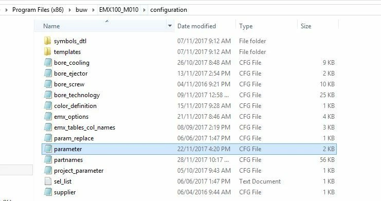

Hai,
Please check the below CFG file available in your installation folder.We just installed EMX10 in one of our windows 10 system and found that parameter.cfg file is missing in the installation folder. may be copy and paste will help.thanks
