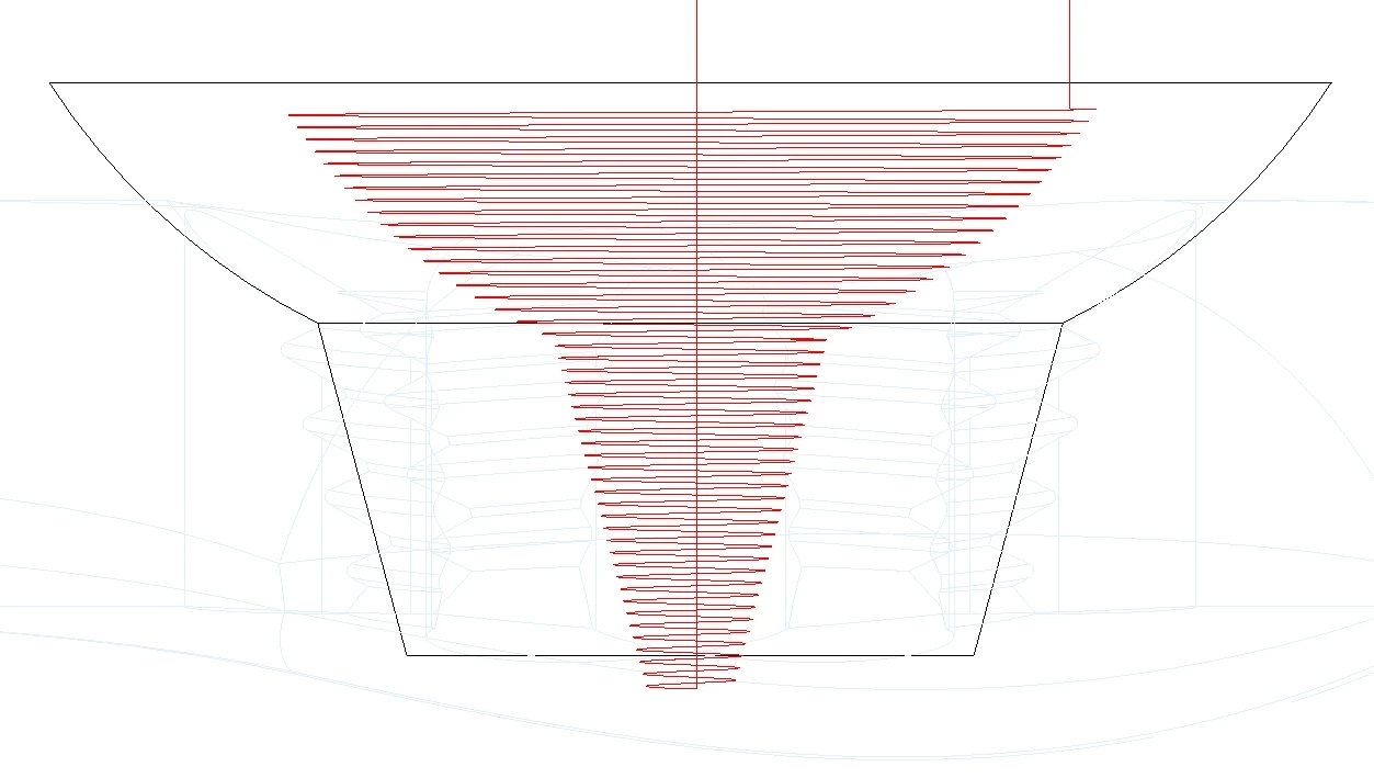

We are having issues creating the following toolpaths with Pro/E. Please note that this is currently possible in MasterCAM.
The goal is to rough the following mill surface with a ball nose end mill in a helical type of motion - keeping a constant helical depth change all the way down:
Here is the mill surface:
When using Cut Line machining with a helical motion the toolpath looks like this. As you can see the helical motion between the spherical and conical part of the mill surface is not a constant plunging depth. This type of tool motion would be fine for finishing the surfaces but we are helical cutting into solid material:
I did create geometry that the tool follows to create the following sequence. This is possible but took a while to create a number of features to accomplish this:
We would like to ask PTC to enhance the Cut Line Helical milling output to provide a constant helical plunging motion down the entire mill surface.

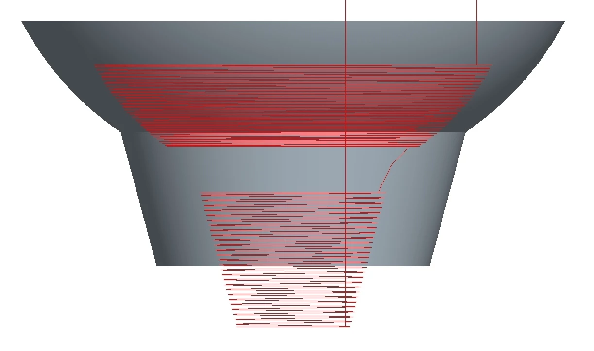

To whom it may concern:
Development is working on the issue… See the picture attached, that shows a test result done with a special xtop (only internal).

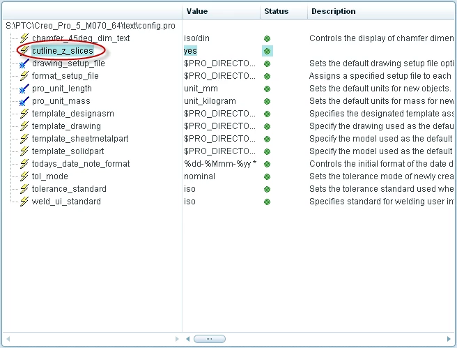

From Creo Elements/Pro (WF5.0) M070 you can use the config.pro options :

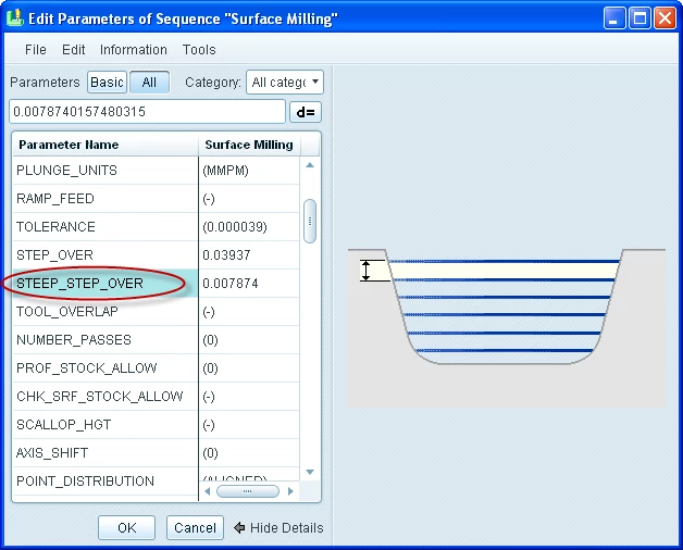

Inner-cutline and Steep_stepover for extra slices on steped holes
cutline_z_slices yes
Steep_Stepover - Drive the stepover at the selected inner cutlines...

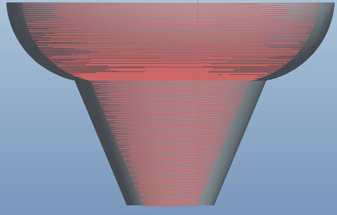

I know we discussed this before and the solution was posted here, but I'd like to share some screenshots from Creo/Elements Pro M070 with Mike's problem solved:
The picture above is no longer from another CAD/CAM system... 😉
Thanks PTC and customers who reported this issue...
