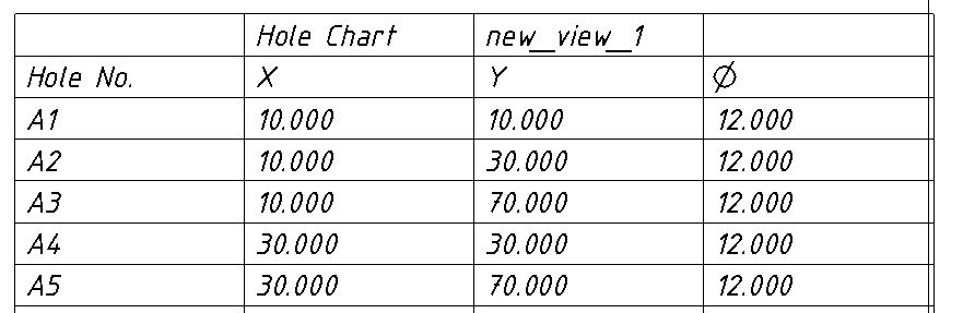

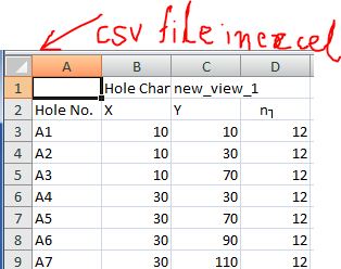

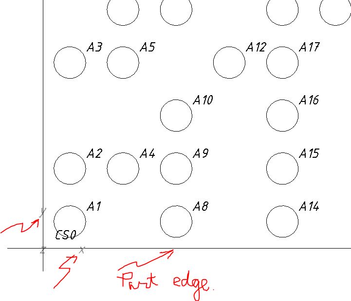

I think using a Hole Table would be a better way to do it. You can get the X and Y coordinates with respect to a selected Co-ordinate system. You can then export the table to a csv file which can then be opened in any spreadsheet application.
It is important to note the orientation of the co-ordinate system. The Z-Coordinate should be PERPENDICULAR to the SCREEN. The hole table would only export the X & Y co-ordinates.

Thank you both for your help. The hole table is quite useful and I can make that work for my situation. Being able to export the table as a .csv file is really handy. It will also make a nice document for record keeping purposes.
I am a little annoyed that the view has to have the coordinate system pointing normal to the screen. What purpose does that really serve. I should be able to use any cordinate system that I choose, regardless of how my view is oriented. Also, it will not let you pick coordinate systems as an option to list. Instead I have to place a point on each of my coordinate systems and use those. This is not a big deal beacause I will just update my user defined feature to do this for me.

Actually if you use the hole table to list the datum points it will list x,y and z coordinates.
Josh
Jul 9, 2012 5:12 PM UTC
Ah, I was assuming only X &Y because that's all I've ever used them for... and that's what the above graphics showed (x, y, and diameter).
Thanks for the correction!
