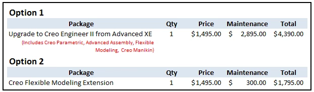

Our Wildfire 5 licenses (PROE_FAPAAX) run Creo 1.0 just fine. (We are on maintenance). We do not have the full Manikin functionality or the Flexible Modeling Extension. In order to get these new features, we will have to convert our existing licenses to the new Creo Engineer licenses. Since the licenses we currently use are a bundle of Foundation Advantage, Advanced Assembly, and Windchill, the new licenses we would get would be the Creo Engineer II ones. To upgrade a license from PRO_FAPAAX to Creo Engineer II is $1,495 (US) (again, we're on maintenance - we can already run Creo 1.0). Because the list price of the new license is more than the list price of the old license, annual maintenance would go up as well (from $2,695/yr. to $2,895/yr.). We don't intend to upgrade all of our licenses, just a couple so a few key people can use the Flexible Modeling Extension.
Here are a couple of pictures that show what I'm talking about. This first one compares the difference between upgrading from one license to another vs. buying the Flexible Modeling Extension outright.

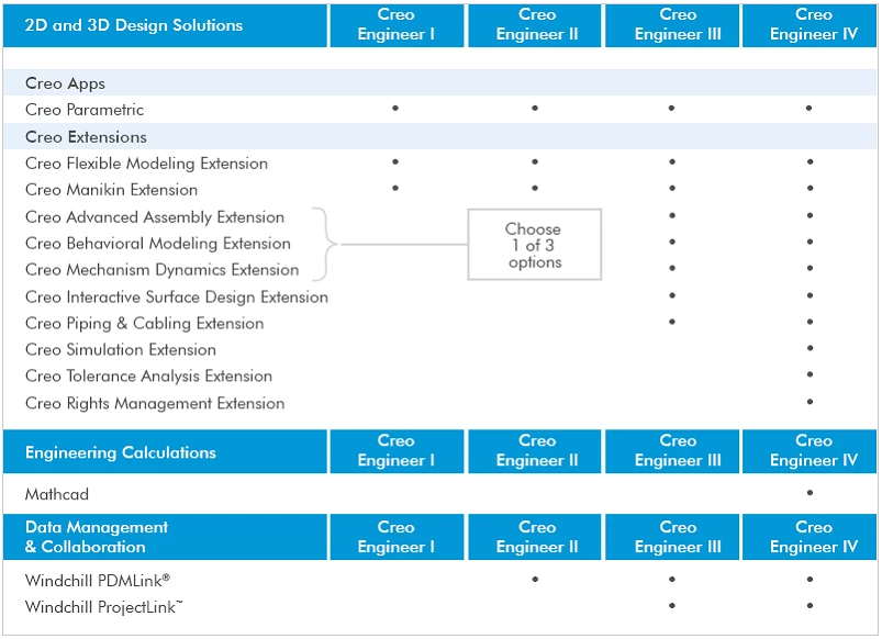

This next picture shows what features are included in each of the new Creo Engineer licenses.
