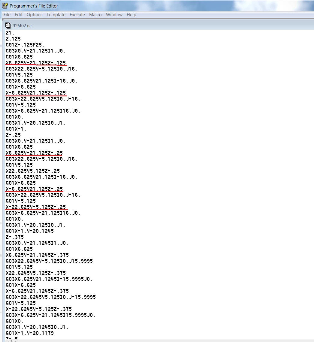

Extra line in post, causes dwell. Why? How do I fix it?
Thanks for reading, I hope someone can help.
Look at the attached G code (underlined code is the problem and redundant) and tell me why this is, and how to get rid of it.
Jon

    The machine operator called me over to see the marks that were left in the part, he looked at the G code and saw why the marks were left, the repetitive G code locations in the post caused the dwell that marked the part.
    This only happens in Volume machining, I reposted using Trajectory, and Profile machining (with the same post) and the double line in the post was not there.
    Attached are the machine parameters, I hope this helps.
    Jon

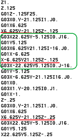

    Though this is not sufficient to understand the problem, I have a few guesses
    With the following piece of code
    I generated your tool path the hard way!!!
    Your tool moves from [22.625, -5.125, -.125] > [22.625, 5.125, -.125] > [6.625, 21.125, -.125] > [-6.625, 21.125, -.125] but the next line is repeating the same coordinate which is causing the dwell.
    This is because the program is trying to align the tool to a correct starting position of the G03 command that follows.
    This may be because of your "CORNER_FINISH_TYPE  FILLET"
    or if it was a desired feature, try changing "SCAN_TYPE   TYPE_SPIRAL"
    Although this might not work for your case at all,
    This is all I could learn from the data provided by you. Could suggest better with the mfg file.

    Does the "raw" CL file show the same thing? I seem to remember having a similar problem because I was getting GOTO values that were slightly different in the 5th or later decimal places. The numbers that were being posted to the ".nc" file looked identical because they are rounded/truncated to four decimal places. Looking at the ".ncl" file showed the trouble. If I remember, it was because I had a weird discontinuity in my trajectory sketch that Pro/E was trying to "fix" for me.

    I just looked at the GOTO values and 7 places after the decimal the value did change.
