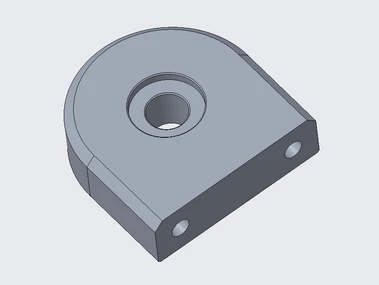

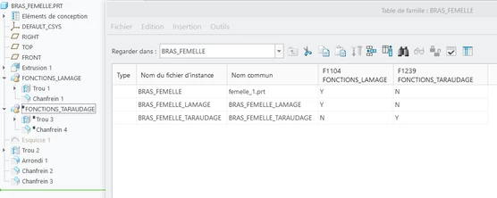

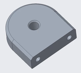

I have a question about manufacturing family parts.
I have 2 parts ruled by a family table. Simple parts, one with a M8 threaded hole and the other with a 8.4 countersink hole. This is the only difference between the 2 versions.
2024-01-15 08_43_42-BRAS_FEMELLE (Actif) - Creo Parametric.png2024-01-15 08_43_56-BRAS_FEMELLE (Actif) - Creo Parametric.png2024-01-15 08_44_28-Table de famille _ BRAS_FEMELLE.png
The 2 versions/functions cannot cohexist in the generic part because the threaded hole and the countersink are both chamfered. The geometry for the chamfer on the threaded hole is destroy by the countersink fonction and vice versa for the chamfer and the countersink. In the generic part ONLY i am forced to desacivate one of the 2 fonctions. No problem with childs parts.
Due to this specification is it possible to have one manufacuring assembly with a "selection " version threaded or version 8.4 ? Or am i forced to have 2 manufacuring assembly with both "child" parts ?
Thanks in advance

Hello, Thanks for your 2 answers.
I try to bring both instances in my manufacturing assembly as you recommand (Michael your point 3). I have an other question :
I attach my common milling features (facing, contourning etc.) to the variant countersinked. I have to choose one of the two. And after i added countersinked feaures attached to the variant countersinked and the threaded features attached to the threaded variant.
But In manufacturing variant threaded i can't use component option in the family table to hide/desactivate the countersinked variant because i use it for my generic operations. I am obliged to have the 2 variant parts in my 2 variant machining . Right ? I can just hide it properly in each assembly.
