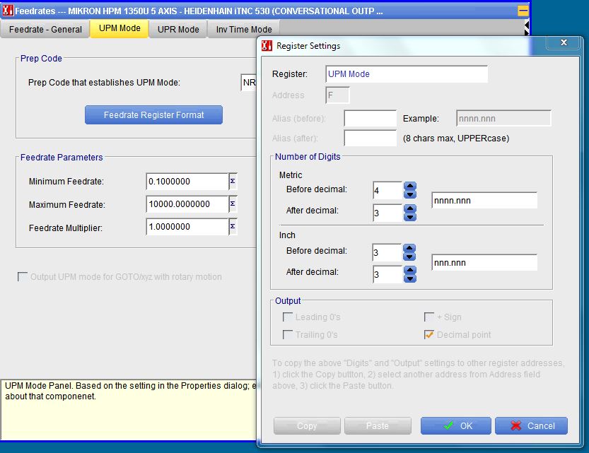

Nov 4, 2016 2:35 PM UTC
There is another place you need to set the F register format.  Since the F is used for several things each feed rate mode has its own format.  For UPM it is set on this dialog box.  The places left of the decimal need to match the Maximum value allowed.

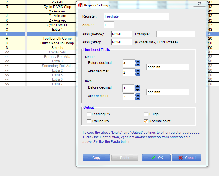

Oct 29, 2016 4:58 PM UTC
Using the Option File Generator ->File Formats->MCD File, select "F" row-> Edit Selected Address, and adjust your formatting.
ex:
Josh

Oct 30, 2016 5:28 PM UTC
hi Josh,
Thanks for the reply,
the formatting setting was ok,
But still I get F1 only
Fred
pesau-21-VisitorAuthor
Nov 4, 2016 3:20 PM UTC
Hi Fred,
Thank for the support , now its working fine.
