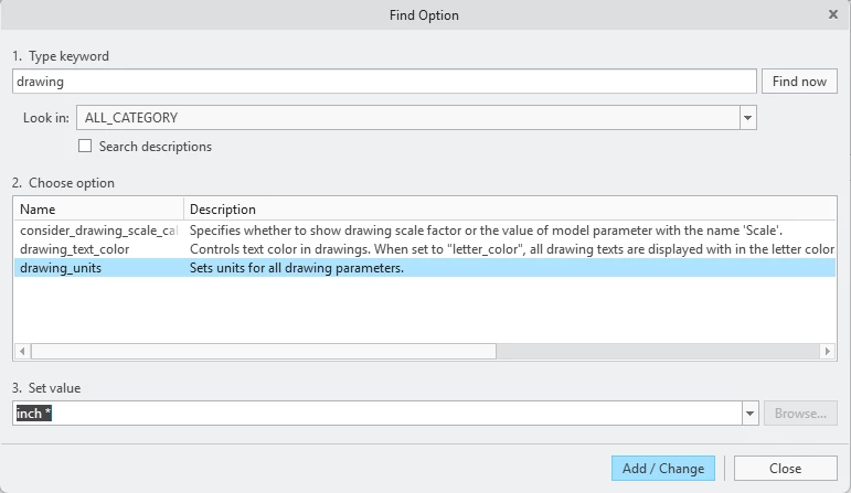

Using CREO 13. I always design in mm, all my files are set up like that.
When I export a sheet metal flat pattern however (via the new direct export feature in CREO 13), the resulting DXF is inches (and the part is huge).
I noticed the DXF contains the following string:
$INSUNITS
 70
1
  0
The “1” is the file setting to inches. Should not be like that.
I don’t know where it comes from.
I have my config.pro set up as following:
pro_unit_length unit_mm
dxf_out_scale_views yes
dxf_out_drawing_scale yes
I also noticed I have a dxf_template.drw. When I open it I notice drawing_units is set to “inch *”, but when I change it it immediately goes back to “inch” when I recheck, so I can’t set it. Not even sure if that file has any relevance.
Also checked some iso.dtl file, which is has drawing_units set to MM
I’m out of options right now. Any ideas?

Oct 21, 2026 4:44 AM UTC
check whether your organization has set a configuration in config.sup file. Settings in “.sup” files override whatever you set.

6-Contributor
Oct 21, 2026 6:39 AM UTC
I just used the built-in AI feature to ask about this and it seems aware that this is a bug:
In Creo Parametric 13.4, there’s a known issue where exporting a Sheetmetal flat pattern via Right‑click on Flat Pattern > Export Flat Pattern writes the DXF INSUNITS as inch even when the model units are mm. This results in a 25.4x scale mismatch in downstream apps.
What you can do now
  • If you must use the new Flat Pattern export:
    • Inform downstream users to interpret units as mm or rescale by 1/25.4 on import, until the SPR is resolved (SPR 17198608).
    • Optionally, open the DXF in your CAM/CAD tool and set/override the drawing units to mm without rescaling geometry (fix INSUNITS only).
  • More stable workaround (recommended until fix):
    • Create a drawing of the flat state and export the drawing to DXF, ensuring drawing units are mm:
      1. In the drawing: File > Prepare > Drawing Properties.
      2. Detail > Change, set drawing_units to mm.
      3. File > Save As > Save a Copy > Type: DXF, then export. This path honors the drawing’s mm units in the DXF.
  • Check/adjust export settings each time:
    • When using Export Flat Pattern, click Settings in the dialog to review properties and mapping as needed (layers, colors, etc.). Unit control is not exposed there for the flat export; it relies on the internal behavior currently affected by the SPR.
It provides links to article CS472733: “Using "Export Flat Pattern" from a Sheetmetal part the resulting DXF is in inch in Creo Parametric 13.4” - Modified: 22-Jun-2026. Resolution: Reported to R&D as SPR 17198608 . It explains exactly the issue I have.
So sadly this is a known issue for months..
Great that the AI knows these things… I don’t know how I would have found this info without the AI. Also no clue when this will be fixed.
