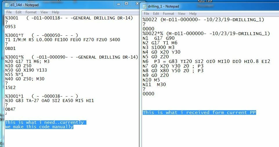

can some one recognize this format of g-code.is it possible to make post processor for this type of out put..from creo post processor..need help
regards
asif
%3001 ( -D11-000118- - -GENERAL DRILLING DR-14)
0953
%3001*T ( - -000050- - - )
T1 I/M:M R5 L0.000 FE100 FEU0 FZ70 FZU0 S400
0BD1
%3001*% ( -D11-000090- - -GENERAL DRILLING DR-14)
N20 G17 T1 M6; M3
N10 G0 Z50
N50 G0 X190 Y133
N55 %*1
N40 G0 Z50; M30
15E2
%3001*1 ( - -000038- - - )
N30 G83 TA-27 OA0 SI2 EA50 MI5 HI1
0B47

If you search the content here for something like "post-processor" or "postprocessor" you might find something informative, but maybe not. Every now and then someone asks for this and there is not a lot of help, because Creo manufacturing is not widely used.
On that note, here's a discussion from the past that includes a lot of info about post processors available, etc.
Previous Post Processor Discussion
Maybe there will be something for you in there. I tend to write my own post processors, but it's not an easy process. I usually end up doing experiments to make sure what I'm doing is going to work okay - something I can only do with the machine available.

Dear KenFarley
First of all thank you for at least reply.because at this topic very few people able to do reply..including me ...i know that without testing its hard to make prefect pp..but dont you worry i can do its testing on my machine ...i have some post processors which is very similar to my requirement but exact as i required.i attach the post processor for i you can able to edit for desire requirements or give me guide line about edit. regardsCapture.JPG
