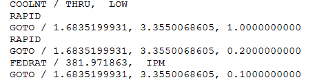

I have been using the constant_load tool path and now that the retract can be controlled I like it a lot. Except, when I change free_feed from rapid to  some value to avoid the collisions Vericut is telling me I have, the 1st move after the tool change becomes a Direct (XYZ) move no matter what I select for a start_motion parameter. Does this mean more screwing around with the post or am I missing something else? Thanks

Hello Josh,
is this a problem of CLDATA or of the post? I.e. is the only change in CLDATA that RAPID is replaced by the specified FEED or are there extra moves?

Feb 6, 2016 5:56 PM UTC
The CLDATA changes and the post matches the CLDATA.
With FREE-FEED set to RAPID:
And set to some value:
Doing some digging in one of the Gpost manuals ( I don't have it right in front of me) by default, the post looks for the first rapid move after the tool change and breaks up the move to XY->Z. This can be over ridden with parameter setting in creo.

Feb 8, 2016 9:50 AM UTC
This is strange!
The only way I can force a plunge down to machining level as in your second picture, is by setting CUT_FEED to the same speed as FREE_FEED.
If CUT_FEED is defined with a different value, it looks like in your first picture.
(And of course if PLUNGE_FEED is defined, it would be PLUNGE_FEED that is either the same as FREE_FEED or generates another GOTO)
