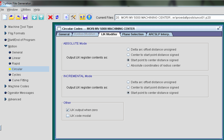

im a fairly new user to pro e had it 3 months now im having a problem that when i generate the nc file when it generates the g3 or g2 code with i and j code if i take more than 1 cut the i and j code are mising, if i just take the single cut the i and j are there. im using pro e 5 and creo 1.0 any ideas would be gratefull

    I'm guessing this is the area to focus on
    Feb 21, 2012 2:12 PM UTC
    You are going to need to look at your post processor. In the Applications - NC Post Processor
    Feb 21, 2012 2:15 PM UTC
    Mickyd11-VisitorAuthor
    Feb 23, 2012 6:29 PM UTC
    thanks nick seems to work
