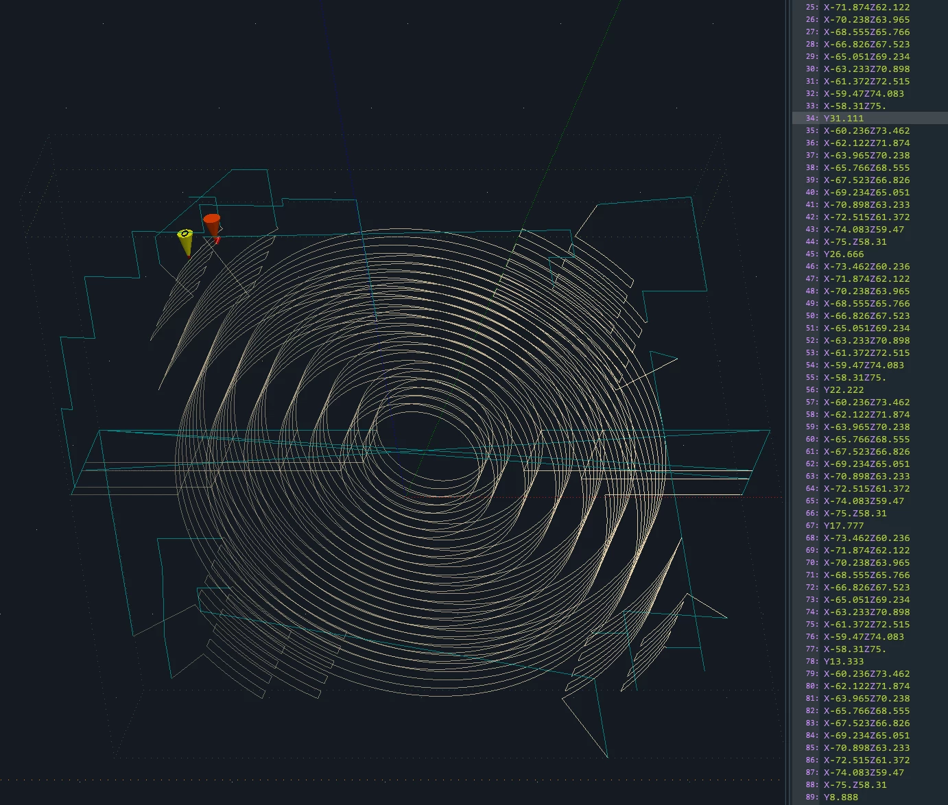

Hi everyone,
I have generated some 4-axis tool paths using the B-axis (rotating the stock), However, every time I export the Gcode it only has XYZ movements.
I know that my tool paths are not great and there is still a lot of work needed so any suggestion is welcome, however the most important issue I need to solve is that the Gcode it exports is different than the toolpaths. So any help would be appreciated.
I'm going to leave the Creo (Creo 9.0) file and a screenshot of the CNC interface for reference.

In order to output code that uses a rotary table for 4-axis cutting, you need to have a post-processor set up to specifically handle this kind of motion.
You define this under Applications->NC Post Processor
You have to define the Machine Type as "4 - Axis Rotary Table". Or at least that's what I have.
There are a lot of things you need to know about the specific machine, in particular the way it handles the angles on the rotational axis.

Can you show the coordinate system for reference?  Are you saying that the G-Code after post processing isn't right, or the values you see in the play path screen don't seem right?

I ended up figuring it out, I didn't realise that the post-processor needs to be selected after it's configured, so I kept modifying the PP but I kept selecting the wrong one. Everything is working correctly now, Thank you for the help.
