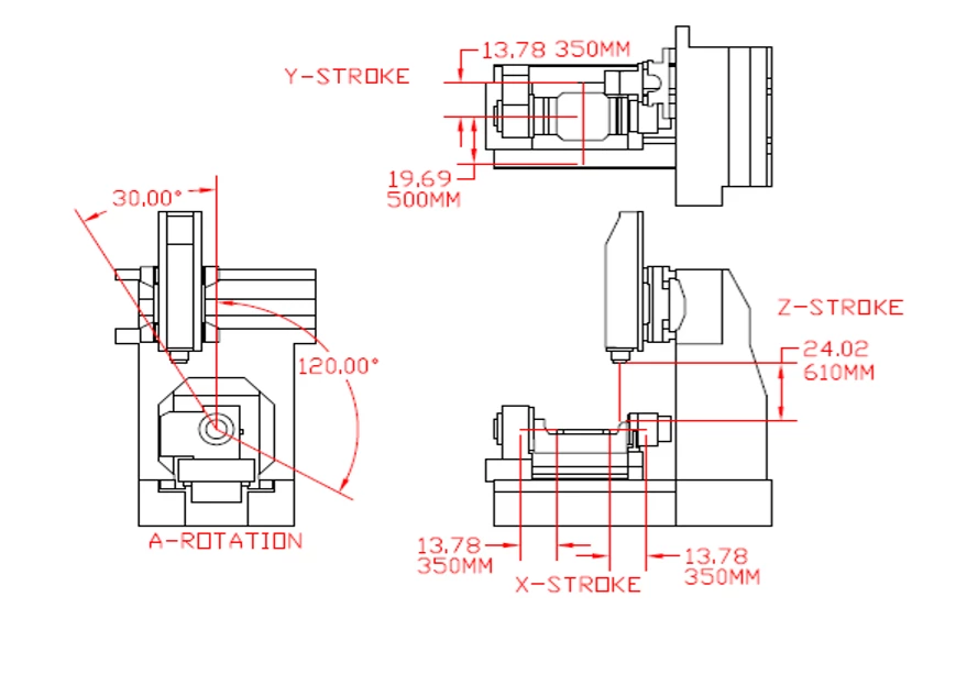

I am trying to tweak a postprocessor for 5 axes machine with Fanuc 31i A5- double tables A/C. In 3 axes is fine, but when I start rotated the axes then my Y axis is way off the track, like instead of going in the positive way the move is negative. Any advice will be appreciated.

Now I saw the CSYS from the machine I has not the same orientation as it is on CNC machine, on machine z-positive up, y positive opposite to operator, x positive left to the operator. In Creo, no matter how I tried, y or x is pointing the other way than on the machine. If I leave the Y axis pointing in the same direction as it is on the machine for the OP and NC sequence than Y-axis is way off as an offset about 200 mm or so. If anyone want to have a look I have attached the test file.

This is the machine sketch, what do you think because I don see any offset distance that I have to fill in the postprocessor.
