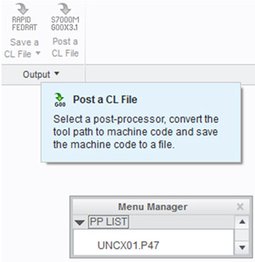

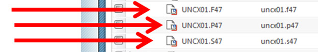

GPOST is packaged with Creo\NC but is not fully compatible with PDMLink requiring that the post processor files (3 files per post) reside at a local hard drive or network location.
I would like the ability to configuration manage these files.
I should have the ability to point at a wtpub location via my config.pro and the necessary files should be retrieved to workspace when/if necessary – similar to drawing formats, startparts, etc.

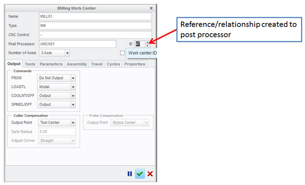

The workcell definition allows for a post processor ID to be defined – this could define the relationship/reference to a specific post processor which could drive retrieval of all associated files.

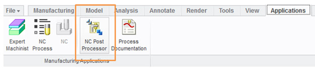

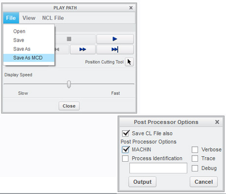

All post processor related activities should function normally, as they do when config.pro is pointing to a local/network location, including but not limited to the 3 following entry points:
SPR1450930 still applies:
Post Processor files should be made Wildfire workspace and Windchill aware. Currently post processing files need to be stored in local file location even though config option gpostpp_dir can be set to wtpub location. Effects MPM Process.
CS11101 – is not properly defined, does not address the need to specify a wtpub location, only mentions workspace which does not solve the problem.

  • I had to manually add the 3 post processor files to my active workspace

  • I was able to post both ways I know of from Creo and launch the NC Post Processor application

  2. Automatically add/retrieve the necessary post files to workspace based upon reference defined in mfg .asm
