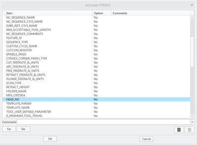

Did you check your PPrint table if HEAD_NO option is set to yes.

but when I change HEAD_NO to Yes in the PPRINT, I get :
PPRINT / HEAD_NO : N/A
I need the CL word to trigger a macro in my post.
Thanks for helping to look for a resolution.
May 9, 2018 1:43 PM UTC
I suspect that your work center type is set to "Milling"
To get head number display correctly the work center type need to be "Mill/Turn" or "Lathe"
