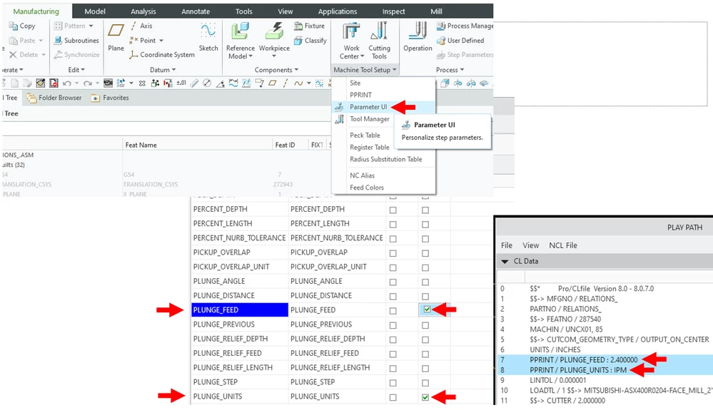

How set in Creo Parametric values for PPRINT parameters?
I am using Creo Parametric Release 6.0 and Datecode6.0.4.0
How set in Creo Parametric values for PPRINT parameters (for example):
PLUNGE FEEDRATE & UNITS
CUT FEEDRATE & UNITS
RETRACT FEEDRATE & UNITS
FREE FEEDRATE & UNITS
Are these parameters set automatically by the values assigned in each NC sequence of feeds, or can they be assigned for each CNC sequence to the user, regardless of the feeds used?

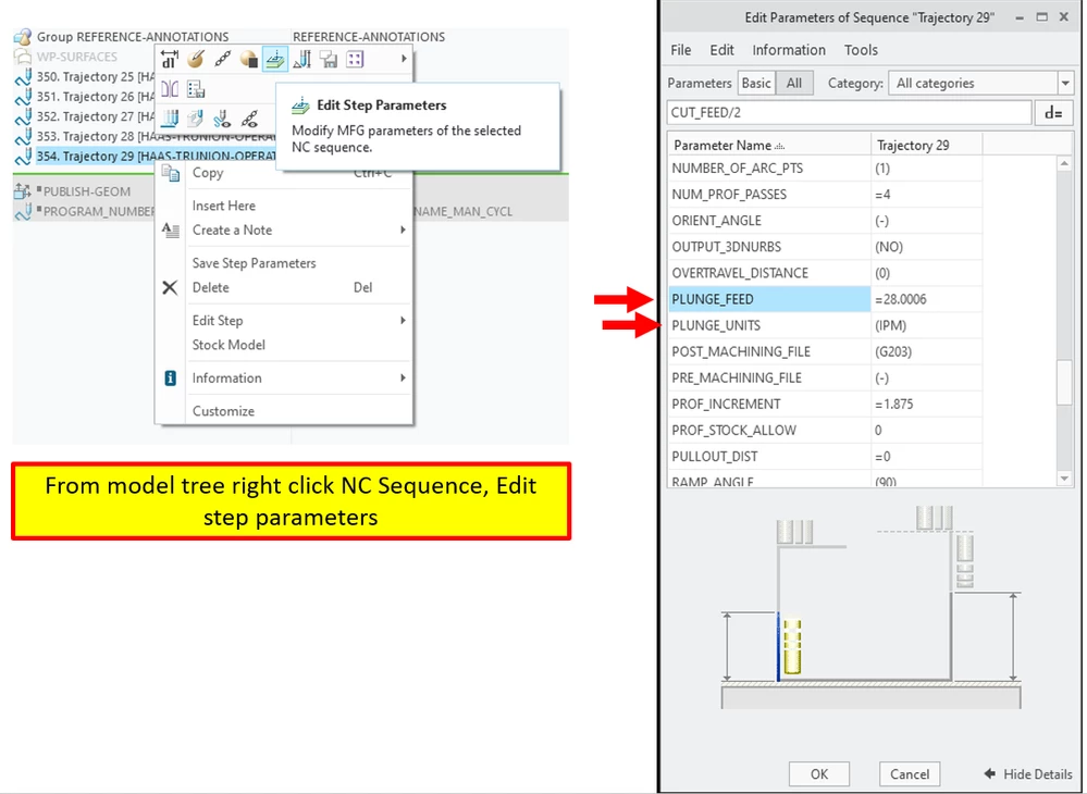

the values are driven by the NC sequence parameter value

Feb 13, 2023 11:09 PM UTC
Thank you for answer, BryantMorgan!
But where did the values for PLUNGE_FEED (=2.4) and PLUNGE_UNITS (=IPM) come from (in your drawing) ?
At what stage were these variables assigned to PLUNGE_FEED and PLUNGE_UNITS?
Explain, please!

Feb 16, 2023 11:12 AM UTC
Values of PPRINTs assigned ONLY from NC sequence parameters!
Thanks to all! Issue resolved!
