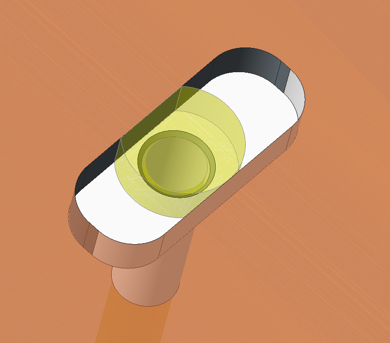

Hey everybody,
When i place ejectors using EMX, the cut which is generated is always very close or coincident with the ejctor shaft. See pic:
This makes it difficult to add a champfer in the hole.

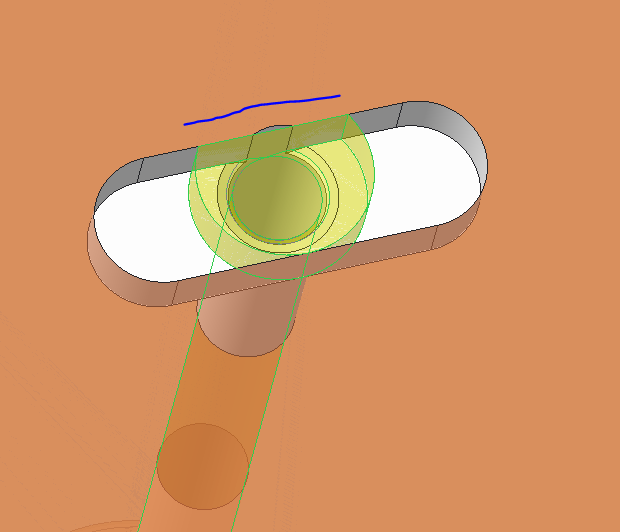

I would like the distance from center of ejector to rotfix surface to be bigger. See below pic:
Where can i find the parameter file, from which i can increase this distance??
Best regards Clement

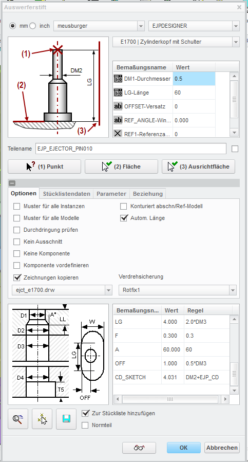

If you have a look to the Component Dialogs bottom area you will find the dimension OFF which is responsible for your described issue.ejp_rotfix1.PNG
In the last column you will also find a RULE which presdefines the OFF value depending on the DM3 Diameter: In this case 0.5*DM3.

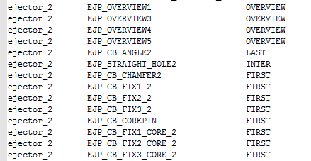

In my example I assemble an ejector pin which uses the template: "ejector_2.prt"
In the udf_data.txt all udfs used for the template type "ejector_2.prt" defined in the Section EMX_UDFS (See picture below)

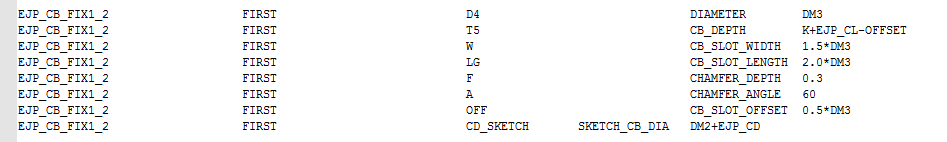

You will find the udf EJP_CB_FIX1_2 which ist responsible for the cut out of type Rotfix1
The rules for this UDF are defined in the udf_data.txt a bit further bleow in the the section EMX_UDF_VALUES
You can now either change this rules to maybe to 0.6*DM3 or what ever you like.
