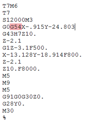

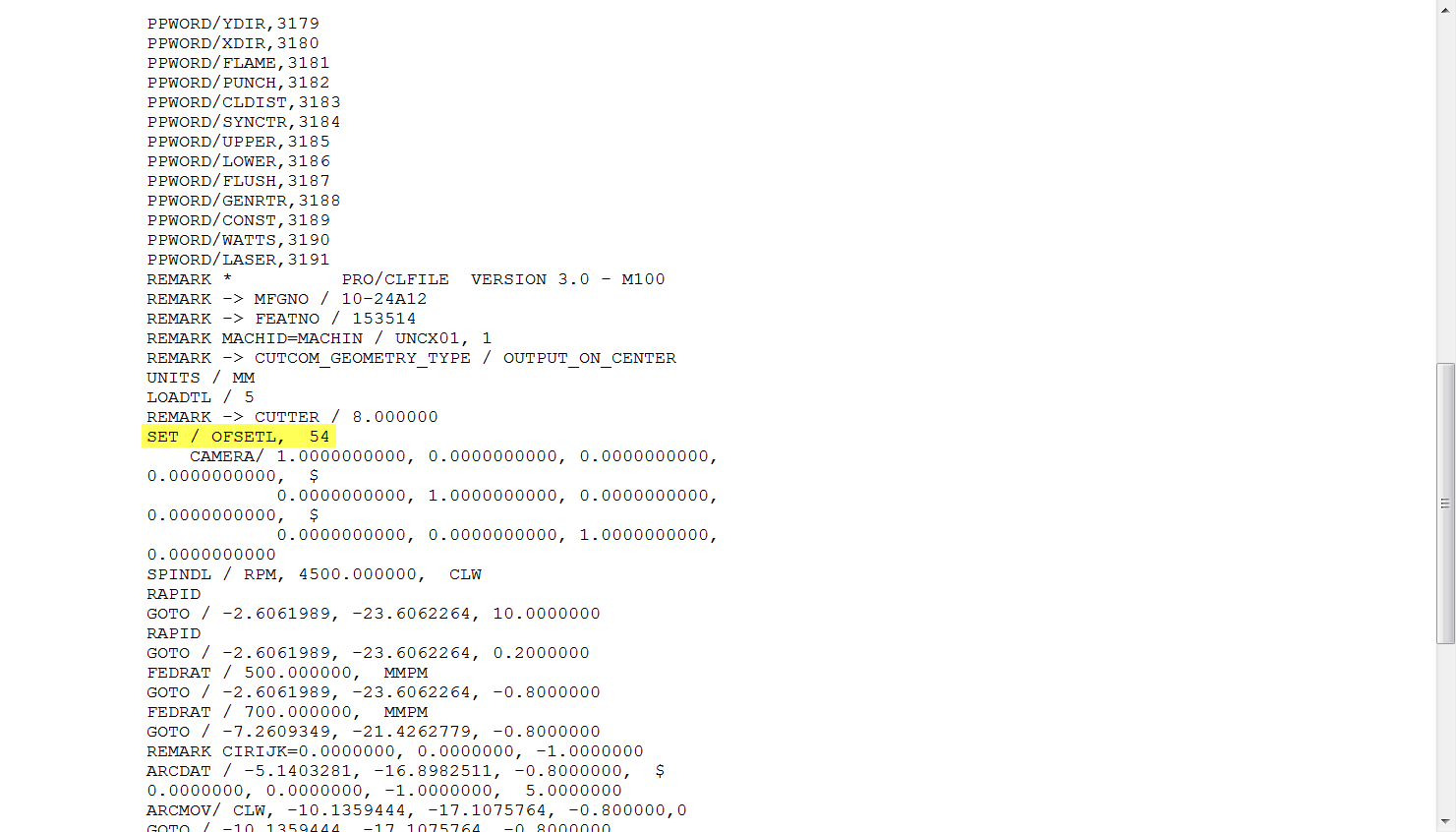

After testing, I still can't post G54 in the CNC program. Do you know why?

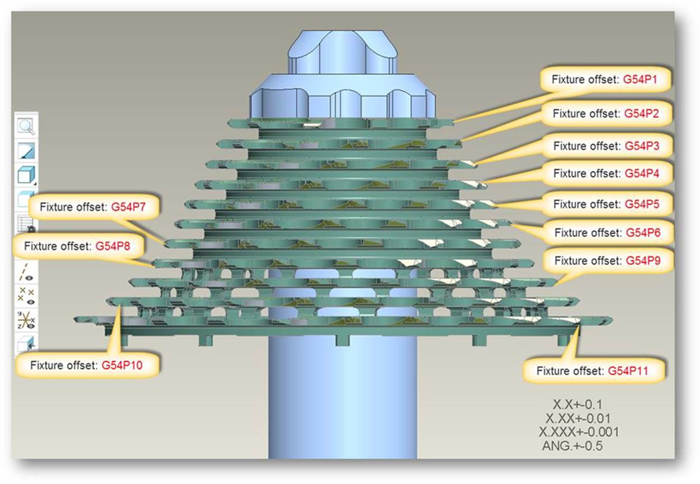

I would like to use FIL to generate G54P1 or P2 etc when I was set up deference fixture offset in each cog of my machining part. ( Like following illustration ).

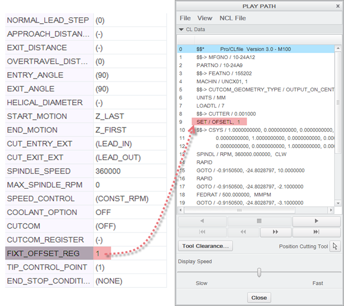

1st, I set up 1 into “FIXT_OFFSET_REG” parameter so that CL generated “SET/OFSETL, 1”.

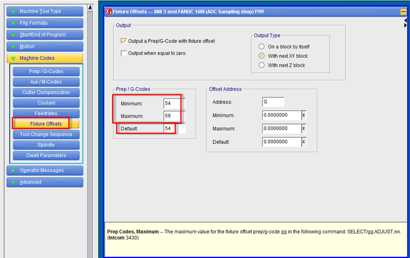

2nd, I set up Minimum for 54, Maximum for 59 and Default for 54. Please note the default.

My purpose, I want to know how to get “FIXT_OFFSET_REG” parameter value then insert a text “P” and the value in the G54 (Default value) by the side?  (Like G0G54P1X-.915Y-24.803)
