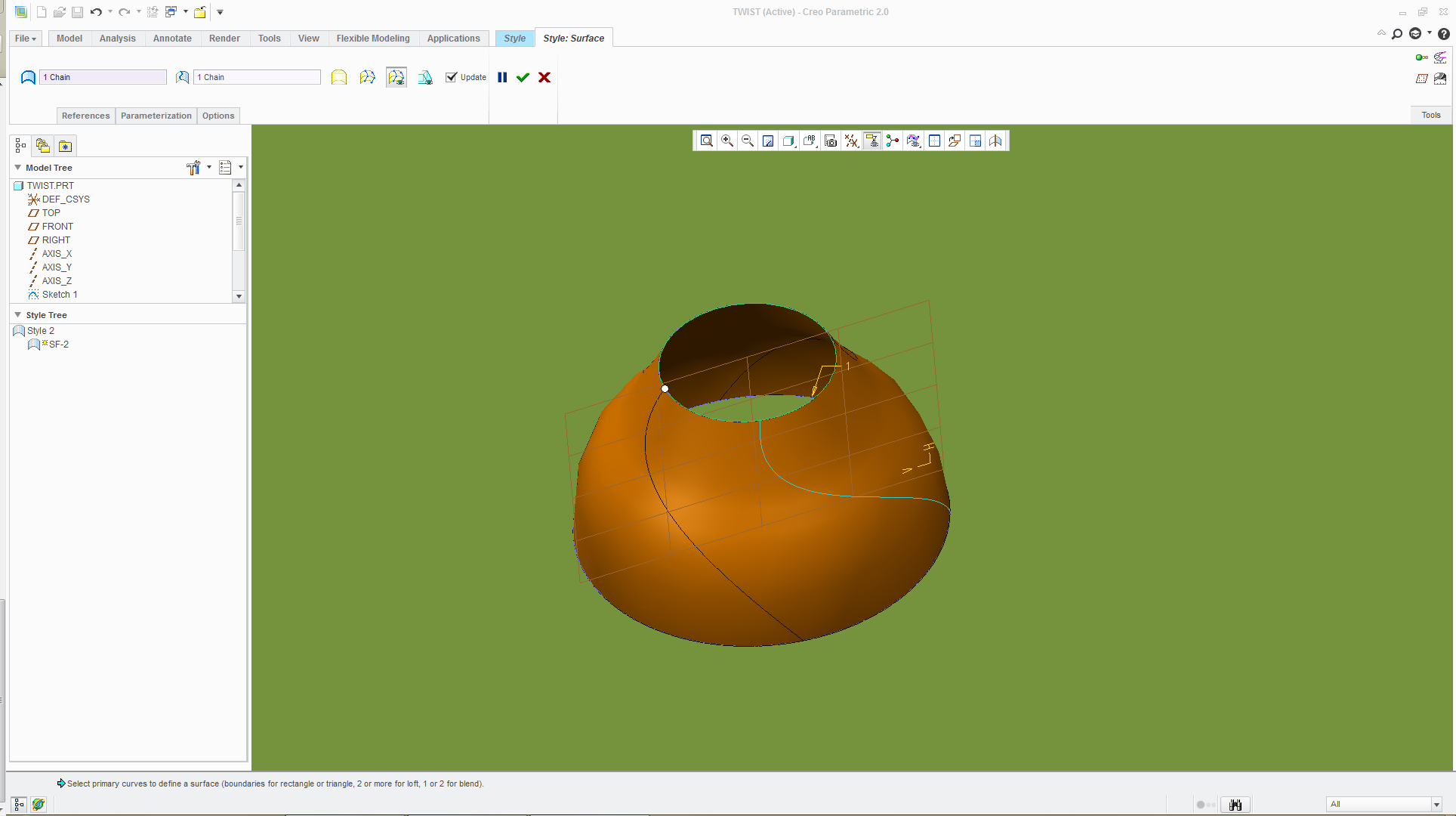

You can do this using style feature. (You need an ISDX license)
SylvainA.1-VisitorAuthor
May 8, 2012 12:24 PM UTC
Could you explain me how to do it?
I am in the styling menu but I can not figure out how to make a revolved surface...
Thank you
James621-VisitorAnswer
May 8, 2012 12:39 PM UTC
Edthewrist is right.
Make sure you select only one boundary chain (circle) and one inner chain (your 3D curve) while creating the surface.
~Jakub

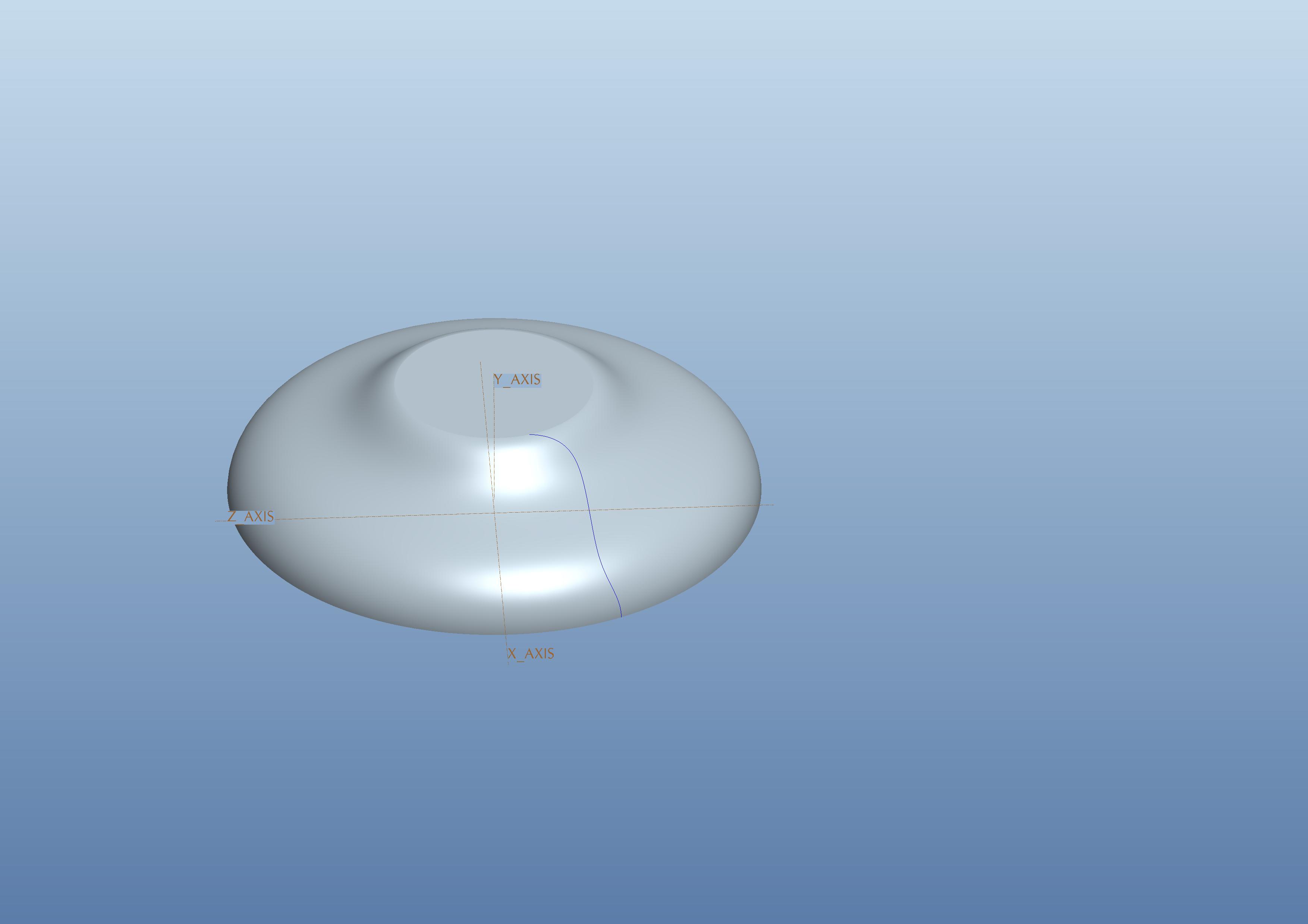

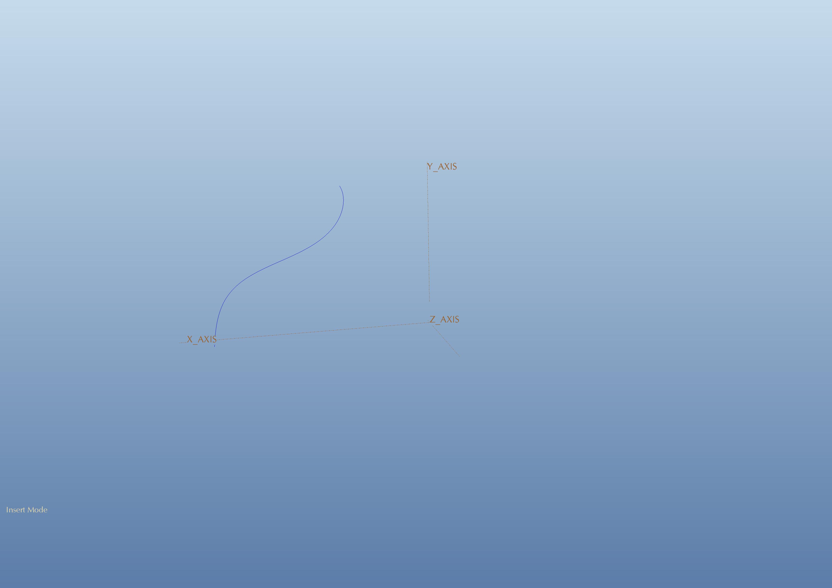

Try to use variable section sweep! It will work. First you have your 3d curve:
You will need to create a curve instead of centerline of rotation and you will use it as first curve and then yo will pick your 3 d curve as second one.prt0001_2.jpg

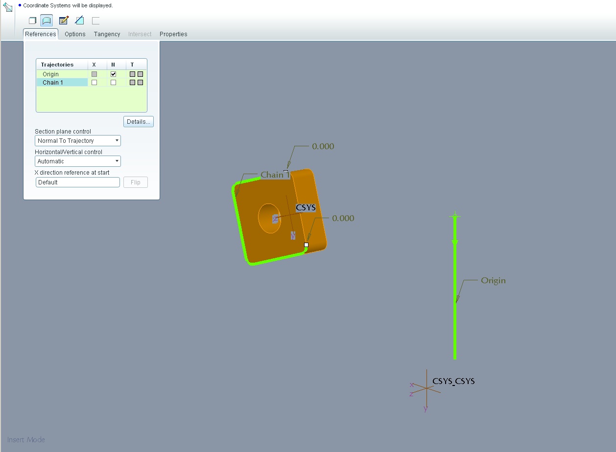

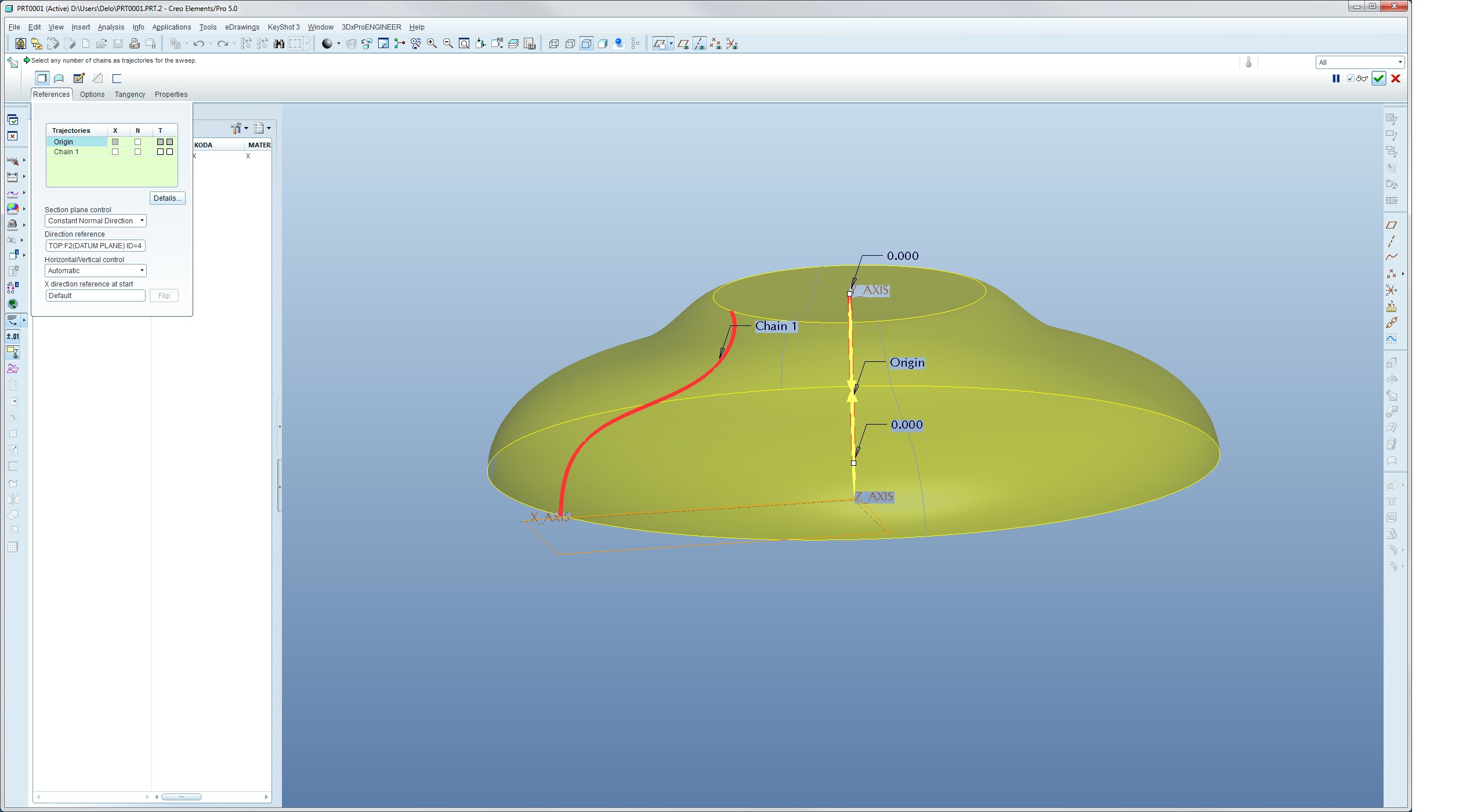

Then go to sketch and create sketched circle with center on first curve and diameter will be driven by your 3 d curve.prt0001_3.jpg
In this way you can create surfaces or solids. Sometime you will need to use constant normal direction for plane control.prt0001_4.jpg
Variable section sweep is rely powerful tool.
If you have any further questions please ask!

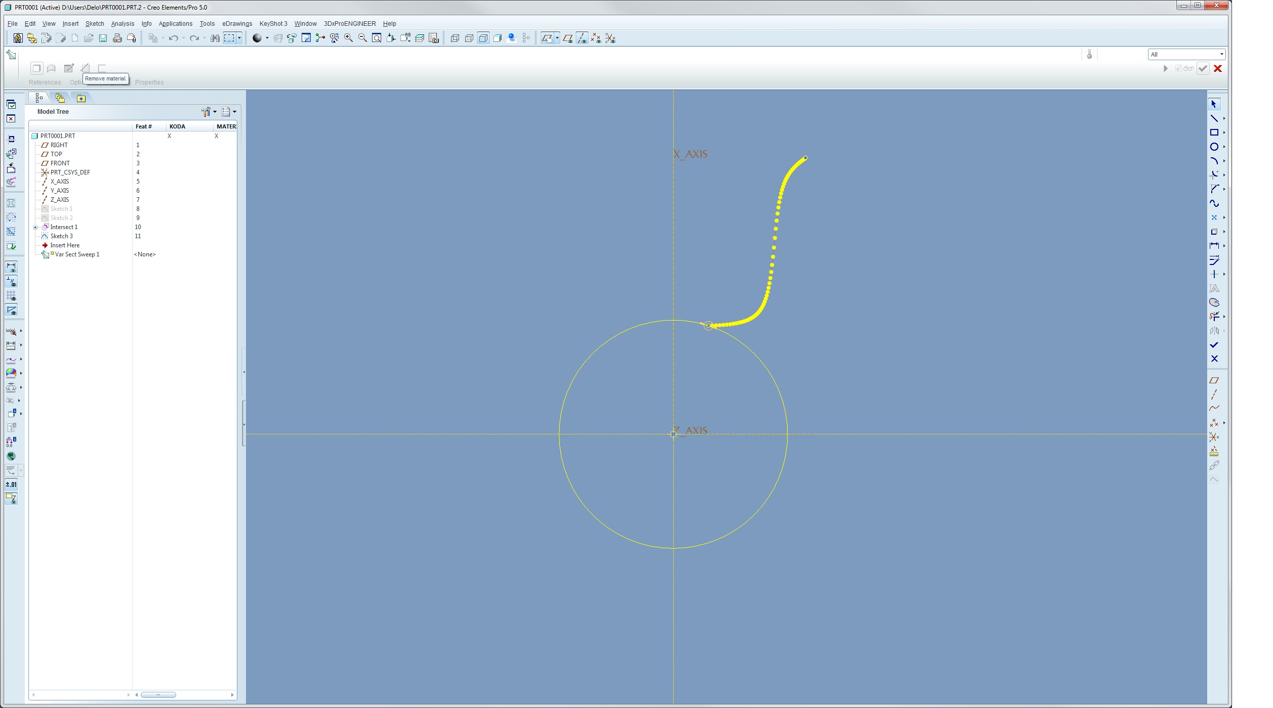

May 21, 2012 6:01 AM UTC
I tried it, but in this case it does not seem to work (the chain has multiple points at the same "level"):
May 21, 2012 6:10 AM UTC
Can you send me 3d model, please! I will see why is not working!
