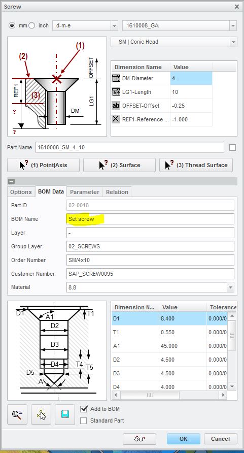

In EMX 9 m023 the concal screw bom name is marked as Set screw. please let me know how to correct it as csk screw.thanks in advance

Hello Abhinand,
here is my answer. You can also change this value easily by yourself.
Tip: Set up custom BOM Names in EMX Options > Part Names
Have a great day,
Thomas

It is ok now, thanks Thomas.
