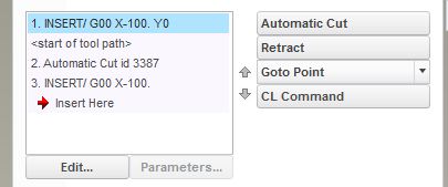

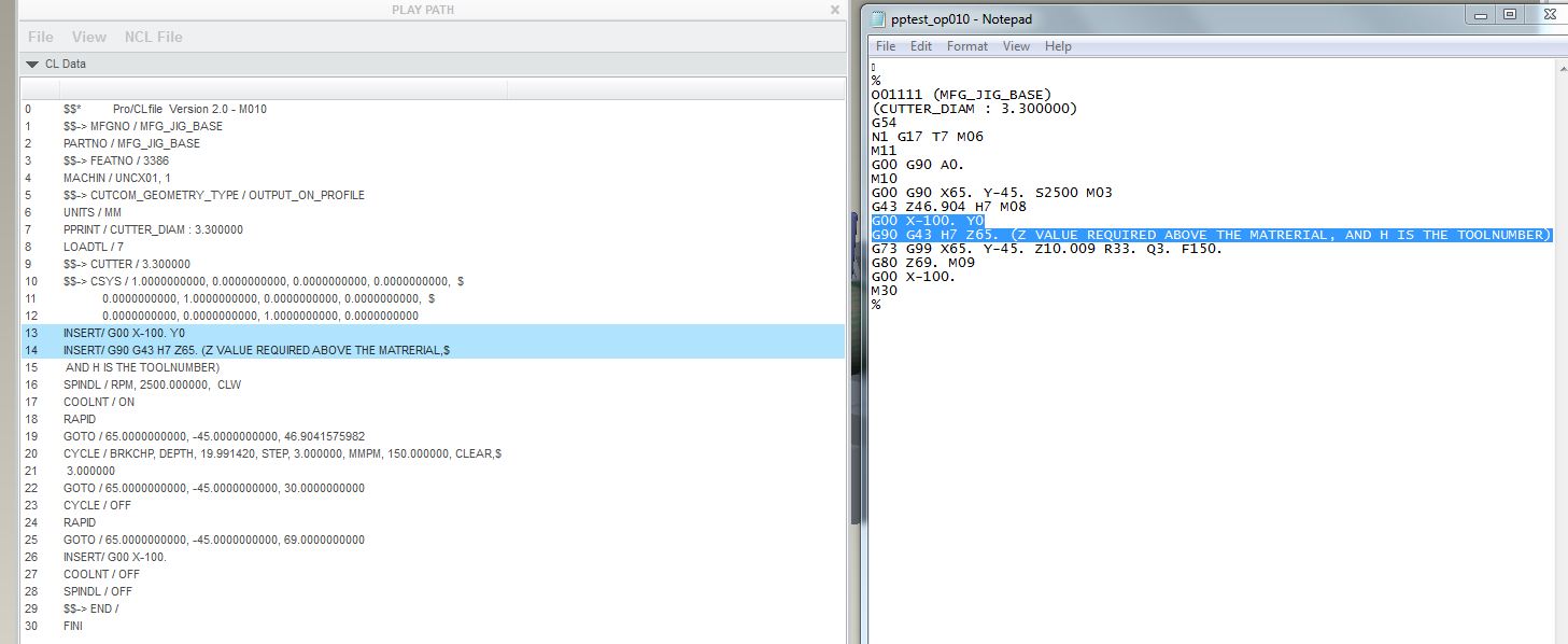

    Jul 17, 2012 9:53 PM UTC
    Hello Olivier,
    I am able to insert the a cl command in a sequence which is very helpful. One thing am not able to work out properly is, It happens sometimes that i have long tools in my tool changer (Haas Minimill), and that after the tool changing the tool tip is below the retract plane. When the sequence then starts a collision will occur. What i normally do is program some lines in where the tool tip moves above the retract plane before the programmed sequence starts. My intention was to insert this with a CL command, however it becomes in the wrong place. I have highlited my inserted lines.Both inserted lines should move up 2 lines. Does anyone have an idea?
    Paul
    Jul 18, 2012 8:23 AM UTC
    Hello Paul
    I think this happens because you have forget the $ at the end of the INSERT
    You shoud have in your CL command
    INSERT/G00 X-100 Y0$
    INSERT/G43 ....TOOL NUMBER)$
    Hope this helps you
    Olivier
