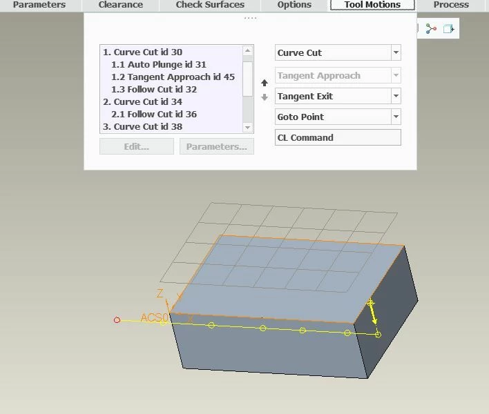

I included a model (in CREO 10) that should solve your issue.
1 Create a sketch with a curve split into your distance segments.
2. add a trajectory
  2a In TOOL MOTIONS add a CURVE CUT for each curve segment.
  2b delete (CUT) the retracts and Auto Plunges between the CURVE CUTS.

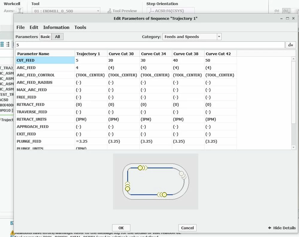

  3c open parameters for each curve cut and modify the CUT_FEED.
        you can also see all the curve speed segments in table form. (see below)

Here is a method that I believe will give you different feeds along a 5-axis (or 3 or 4-axis) trajectory.
Note: this example will assume 4 different feed rates at 0% to 25% curve lenght 25% to 50%, 50% to 75% and 75% to 100%.
1. Create the trajectory
2. In the tool Motions dialog box copy the "Curve Cut"
3. past the Curve Cut three times so you have 4 Curve cuts.
4. Delete the "Auto Plunge" for the 2nd, 3rd, and 4th curve cuts
5. Right click the "Follow Cut id XX" and pick Edit Definition
6 Set Follow Cut to "Ratio"
7. Set End 1: to 0
8 Set End 2 to .25
9 exit with OK
10 Repeat for the next three Curve Cuts.
   10 A. 2nd Curve Cut End 1=.25 End 2=.5
   10 B. 3rd Curve Cut End 1=.5 End 2=.75
   10 C. 4th Curve Cut End 1=.75 End 2=1.0
11. Goto Parameters
12 Click on tools
13 check mark "Show All Value Columns"
14 edit the feed rate for each Curve Cut
