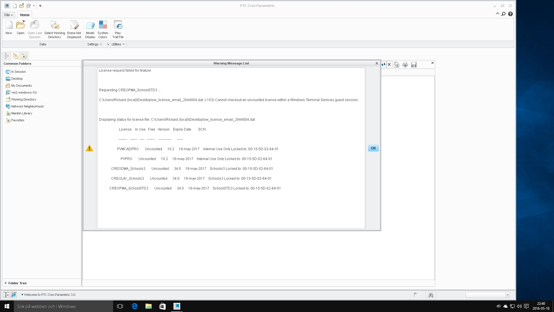

Is it possible to run PTC Creo in virtual machine and connect to it trough Windows remote desktop?
I have installed PTC Creo on a virtual machine in Hyper V, Windows Server 2012 r2, and then I connect to the VM through Windows Remote Desktop. It works fine when I run it locally on the server but it won't work when I remotely connected to the VM.
Anyone that have had this problem and found a solution for it or doesn't exist a solution for the problem?
I've attached a picture of the failure down below.
May 19, 2016 7:41 AM UTC
probably your license is locked, therefore you cannot run Creo via Remote Desktop. You need floating license to be able to do it.

rbemm1-VisitorAuthor
May 19, 2016 3:37 PM UTC
Hi, thanks for the quick response!
How do I obtain a floating license? I've searched on Google on the floating license but didn't find any related information.
TomU
May 19, 2016 6:26 PM UTC
They cost extra.  You have to pay for the floating option.  You will need to contact your PTC reseller.
