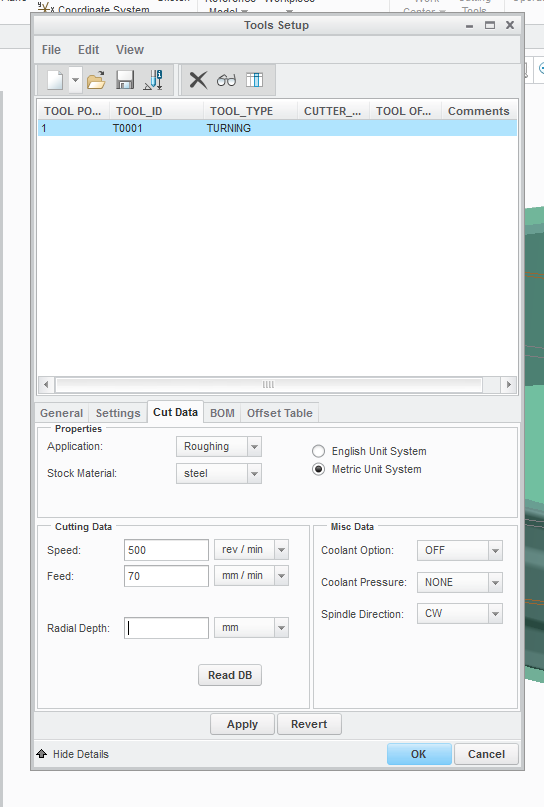

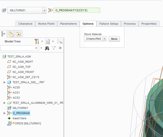

Hi Felix,
Usually every user can define his own custom materials, at first it is a little time consumer but after you can use it whenever you need it.You can try this, when you define your operation (op10) you should define some materials that you are using, of course you can save it and set a config option to read your material library all the time. After you define materials in op10, you open the tool dialog box and in tab CUT DATA you can set up this parameters to have default values for specific material. I hope this helps you.
