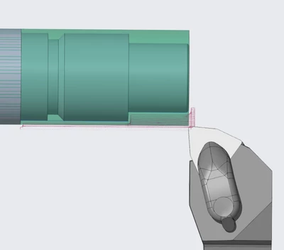

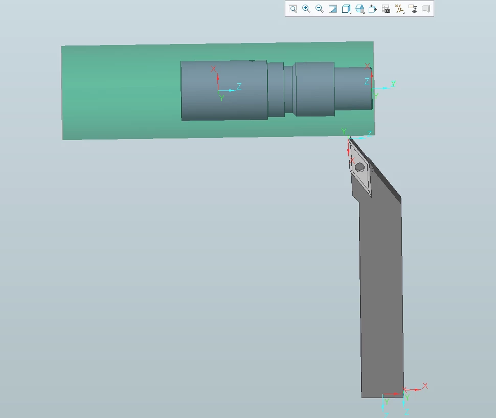

Hi, how do you define the tool for the lathe.
I didn't get it from the instructions
I tried to create a Solid tool and I added CSYS TIP and CREO doesn't want to create paths even though I increased BACK_CLEAR_ANGLE.
Could someone send me an example of how you define this?
Thanks in advance

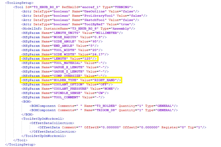

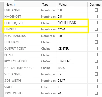

I udpate the tool t3_hrub_r0_8.
Modify tool parameter name TOOL_LENGHT by LENGTH
Modify tool parameter HOLDER_TYPE value by RIGHT_HAND

8-Gravel
Feb 8, 2024 9:57 AM UTC
Hi, thank you.
If I understand correctly it is always necessary to model the tool and the plate, because when I tried to import the step and define the parameters it only displayed the tool, but not the pathknife.png
or am I making a mistake somewhere?
Feb 8, 2024 10:12 AM UTC
Have you tried with no solid tool?
