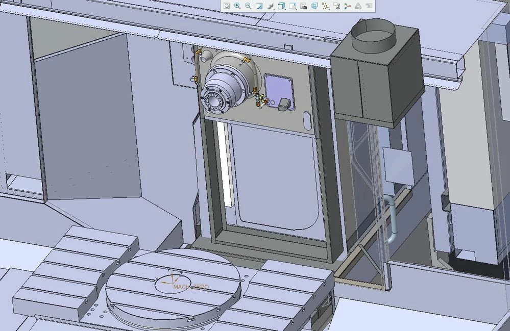

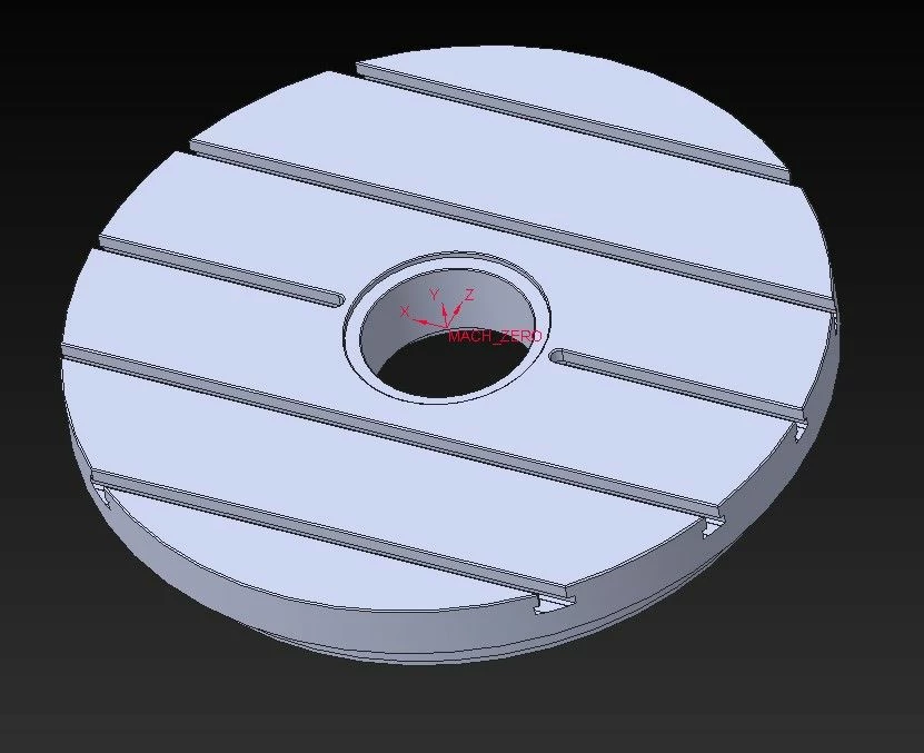

Machine play going from opposite sides (Example B0 to B180) will not rotate.
I have a working kinematic model that will work fine as long as you do not immediately rotate to the opposing side.  If I start machining on B0 and go to B180, the Z travels right through the part and continues machining without rotating the B axis.  But if I go from B0 to B90 and then on to B180, it will rotate as intended.  If I go from B90 to B270, it also will go straight through the part.  My "MACH_ZERO" CSYS match each other, I can't think of anything I have done wrong on my end.  Any ideas?  Or is this just another thing that Creo offers but is broken?
Also, if I start on B180 as my first machining side, then with all following rotations, the tool will go through the part.  I put together the following demonstrations.

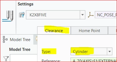

HI
try to take "cylinder" as a type of clearance
Abdel

nlehman13-AquamarineAuthor
Oct 21, 2021 3:32 PM UTC
Thanks for the suggestion, and that probably is the correct answer.  However, when we set that to cylinder, it does not code out correctly.  As far as I know, this is a known issue at Austin NC the last I talked to them.
