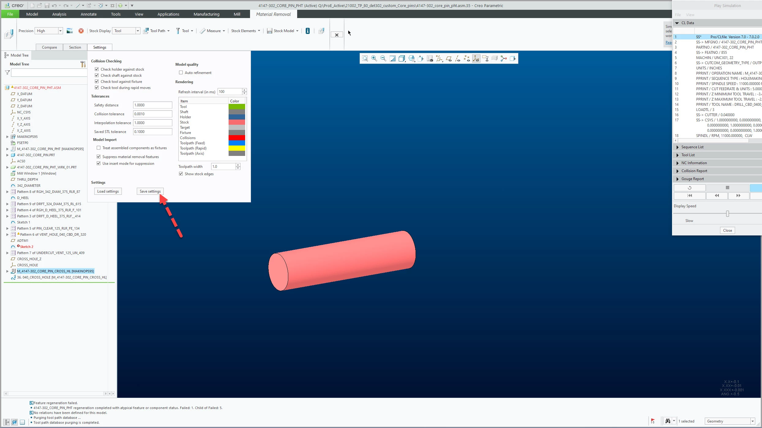

make stop for tool change default in material removal simulation
I always want material removal simulation to stop where tool must be changed.  How to make this a default?
Feb 2, 2021 6:28 PM UTC
If you select stop at tool change from the view menu then do a save of the settings it will save that for the next time you run material removal simulation
Feb 2, 2021 6:32 PM UTC
thanks much.
