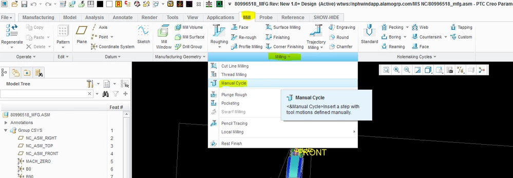

nlehman13-AquamarineAuthor
Jul 24, 2018 12:36 PM UTC
I had already marked the correct answer, but I have since found that the actual correct answer was to use a "Manual Cycle".  I was not aware of manual cycle and want to document their existence for people that may have a similar question as mine.
The Manual Cycle is located on the Mill tab, and then milling.  Manual cycle is the only tool path for which a tool is optional.
